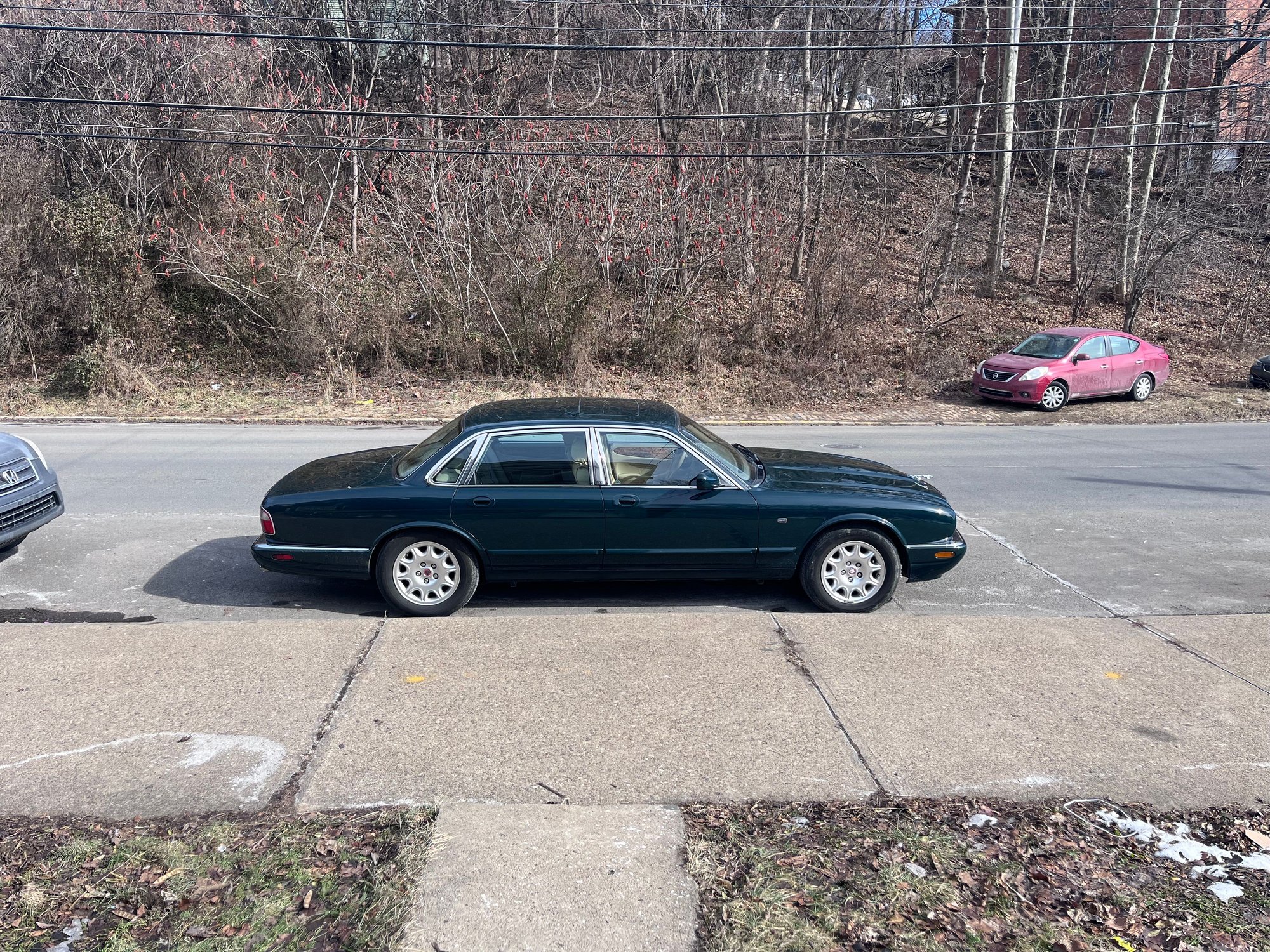

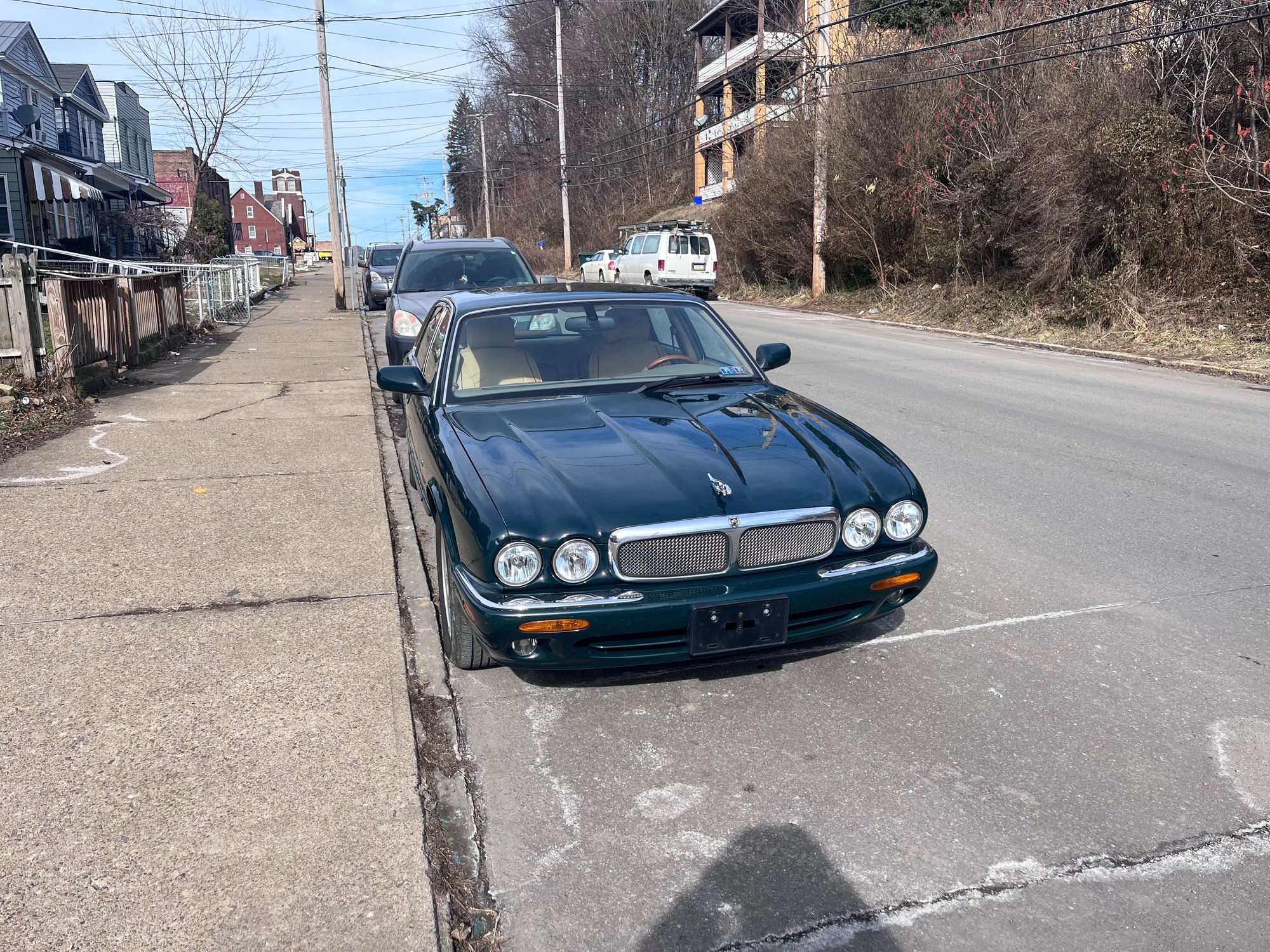

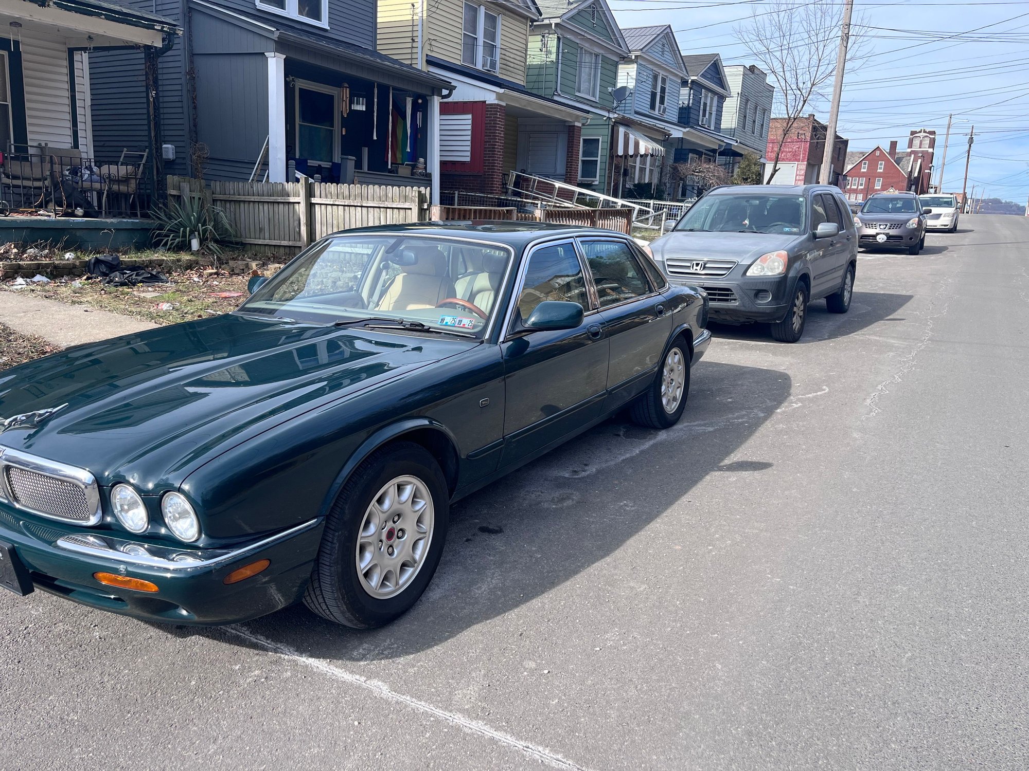

A 2003 (X308 car) XJ sport (N/A engine) will have a 5HP24. You’re located in Pittsburgh Pennsylvania which is North America. You’re saying you have a ZF6HP26 transmission? Do you have an aluminum bodied car or steel? Or better yet, a picture of the car.

yes i bought a transmission from a private owner that stated it was a zf5hp24 for a 4.0. upon further inspection it is a zf6hp26. maybe someone is willing to trade?? not sure. just disappointed it furthers my issue.yes aluminum.
