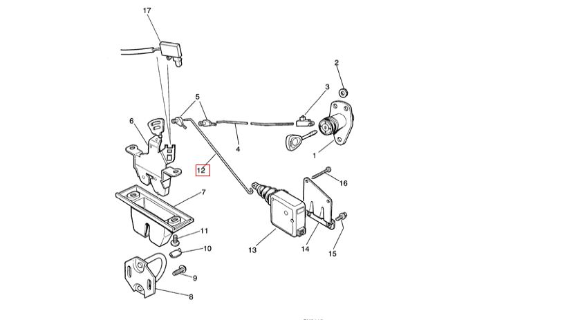

Attached is a copy of the blow up for the trunk lock assembly. Most likely Pc# 12 has worn where it engages the actuator and the release. Unfortunately there are no bushiings so it is metal on metal With the blow up you can get a pretty good idea as to what is hiding behind the plastic cover.
Mine did the same thing and Pc# 12 was almost worn thru and the actuator had a good size groove started.

Well that sucks lol.. As soon as one shows up at my you pull I'll have to go digging
