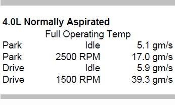

As I mentioned in your thread on the UK site earlier, the MAF sensor was the first one to be checked / suspected.
Although all above readings are static, the above confirms IMO that your MAF sensor has a problem.
Either dirty, a connection problem, but most likely dying.
The readings at higher rpm are much lower than they should be.
The result is that the MAF sensor reads less air than which actually goes through.
Consequently, the ECU initially gives less fuel than needed before the combustion.
Then, your CO sensors sense that your burned mixture is too lean, and compensates this by adding fuel over the standard amount, hence your 'plus' values'.
My approach should be:
1. Clean / spray the wires of the MAF sensor carefully to clean them,
2. If that does not work, check the connector and the pins of the connector carefully, bend them a tiny bit if needed for good contact,
3. If that does not work, replace the MAF sensor.
After that, you can do some readings again, and see if the problem is solved, or if you have to dig further.
But I guarantee you this is a big part of your solution.
Btw, you will not be the first one with a broken MAF sensor, I notice there are more owners running into this recently.
Attached Thumbnails understanding OBD data-jaguar-x308-engine-maf-readings.jpg

I'm not sure you can put much stock in your MAF readings if you are only running the RPM's while stationary as there's a load factor missing that only occurs if the car is moving. (even on a dyno the load is somewhat reduced because of a lack of wind resistance and the lower rolling resistance on the tires although a good dyno can add for that)
Your MAF reading at idle (686 rpm's) is 4.99 g/s and the Jag target is 5 g/s...close enough for gov't work. At 2250 rpm's with no load your MAF reading is 10.88 g/s against a target value of 17 g/s so that's suspect but also 250 rpm's shy so run that sequence again but at 2500 rpm's instead.
At 3260 your pulling 15.57 g/s against a target of 39.3 g/s but that target is for 1500 rpm's under LOAD and sitting in the barn isn't the same thing. Can someone ride with you and use the phone to get readings at various RPM's while you drive?
