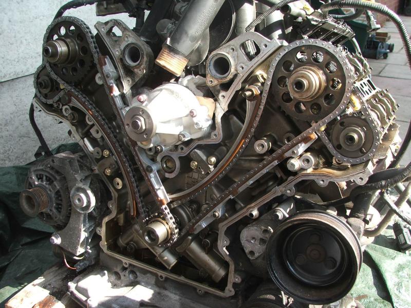

Your primary chain is a so called "Morse Style" silent chain rather than a roller chain as in your the secondary position. A roller chain looks like a bicycle chain.
I do not know if you can see it here, but the engine in the picture below has a primary roller chain.
BTW, apparently some XJRs built after August 2001 had old stock engines installed from the factory since some folks say their cars still had the original arrangement.

Thanks Sparkenzap for the clarification, I do see the difference you are talking about. I'm looking forward to getting her buttoned up, new plugs installed and the oil changed - then I can stretch her legs out without worry.
Everytime I took the car out I was worrying if the tensioners were going to let go....now I can drive relaxed.
