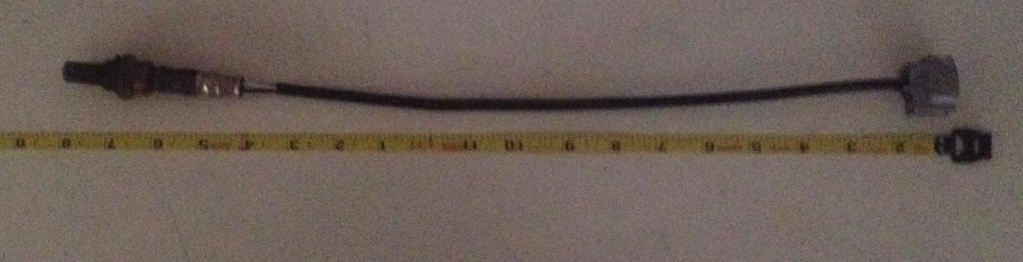

I have one I took off my 2003 XJ8 if you want me to measure it or take photos.

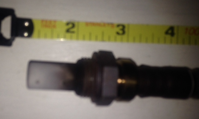

Here are some photos I took this morning -- sorry for the poor quality!
I took this sensor off my 2003 XJ8.

Old Mike, thanks, and that does match what I have.
