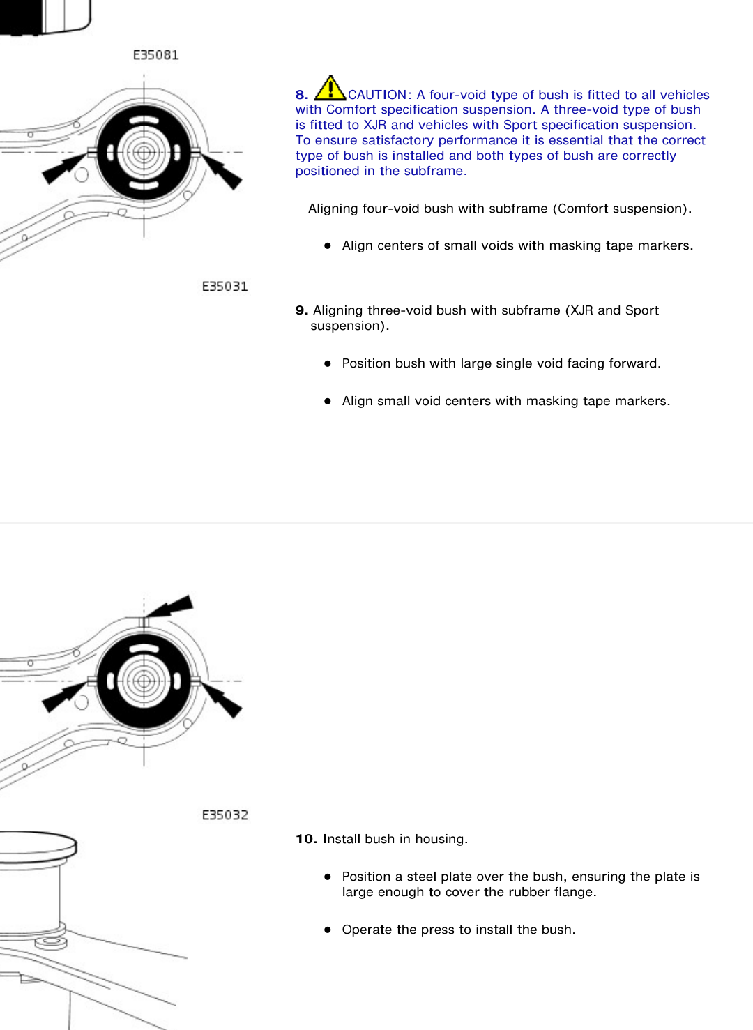

Just to clarify which bishings we're actually talking about here:
Based on the part number the OP referenced, the discussion is about the rear crossmember bushings of the rear subframe — whereas the thread by Nilanium is about the rear bushings of the front subframe.
I recently replaced the rear crossmember bushings myself, though I used genuine Jaguar parts, so I can't comment on the Uro parts specifically.
And yes — the new bushings pressed in very easily, almost by hand. The workshop manual actually states that the bushings should be bonded in with adhesive, which suggests they are not a conventional interference/press fit in the subframe.
One more thing worth mentioning — pay close attention when installing the bushings, as they need to be correctly positioned and oriented depending on which type you have. Apparently there is a four-void and a three-void type of bushing.

Old Yesterday | 07:01 PM
rickyrockrat's Avatar
Joined: Aug 2016
Posts: 3
From: Carson City, NV
Default thanks
Hello nilanium and xjr2014_de,
Thanks for your answers. Yes, xj42014_de has a nice drawing discussing the subframe bushing. What I have is the MJA2595AC bushing in my grubby hands and now it appears this particular part is for the sport suspension. The XJ8 I have apparently has the comfort suspension since the bushings have four little cutouts. Sigh. It appears the comfort bushing can be obtained. Can the sport bushing be used? My instinct tells me I am better off getting the correct comfort bushing but they appear to be somewhat harder to find.
