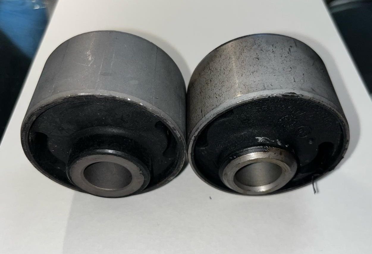

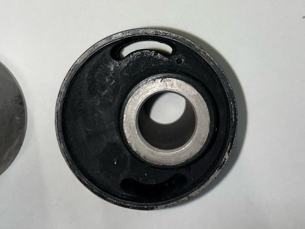

Hi,
in case this is of any help to you guys, I have made measurements of brand new URO bushings and brand new OEM bushings (unopened since 2001). Both in the configuration MNC2370AC.
Measurements are stated in mm & g (millimeter & gram) and written as (URO/OEM)
Outer diameter bushing: 66,25 / 66,91
Outer diameter inside shaft: 34 / 33
Inner diameter inside shaft: 19,25 / 19,4
Width bushing: 38,65 / 37,85
Width inner shaft: 51,05 / 51
Weight: 442 / 305 (the URO ones are considerably heavier)
In the pictures attached you can also see that the holes in URO ones are straight through and in the OEM ones only halfway through.
Old Today | 03:56 AM
Hooli's Avatar
Joined: Sep 2019
Posts: 1,215
Likes: 687
From: Doncaster, UK
No wonder they don't work then.
