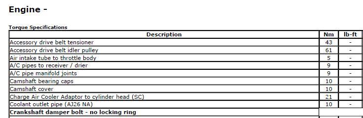

Thanks. I will have a go at that. Is the correct torque setting 11 nm?

avern1's Avatar
Joined: May 2012
Posts: 3,290
Likes: 1,328
From: Winchester, CA
