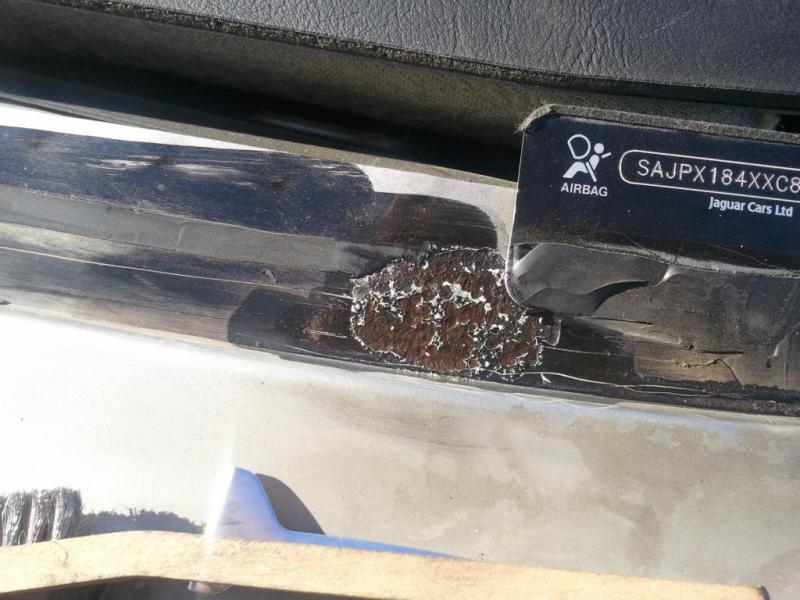

I recently replaced my windshield and had rust around the frame right where the VIN plate is, the only thing keeping the plate in place is a strip of double sided tape.
If you switch out the dash you will not disturb the VIN plate.
