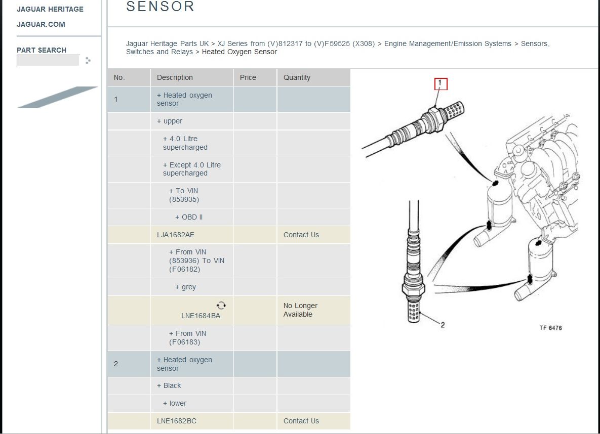

This is what i found for you on NGK site.
I use NGK products on my last car a BMW 735IA
NGK Automotive OE Replacement Parts - In Stock for Your Tune-Up! O2 sensor
http://www.ngk.com/Quickwatch.aspx?zpid=19828
http://www.ngk.com/Quickwatch.aspx?zpid=19874
Attached Thumbnails Wanted: Oxygen sensor replacement recommendations-o2.jpg
