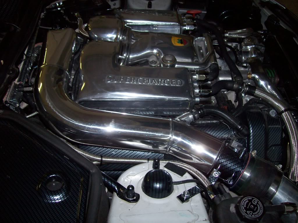

I have custom made 3.5" intake pipes that go from the throttle to the air meter. Then all you have to do is make up plumbing to get air in from outside.
That sure is pretty.

XJR-0220's Avatar
Joined: Nov 2010
Posts: 404
Likes: 70
From: Utah
Yeah those are very nice looking have to let me know what your wanting for one.

Excellent set up , this is the coolest intake I have ever seen on a Jag
