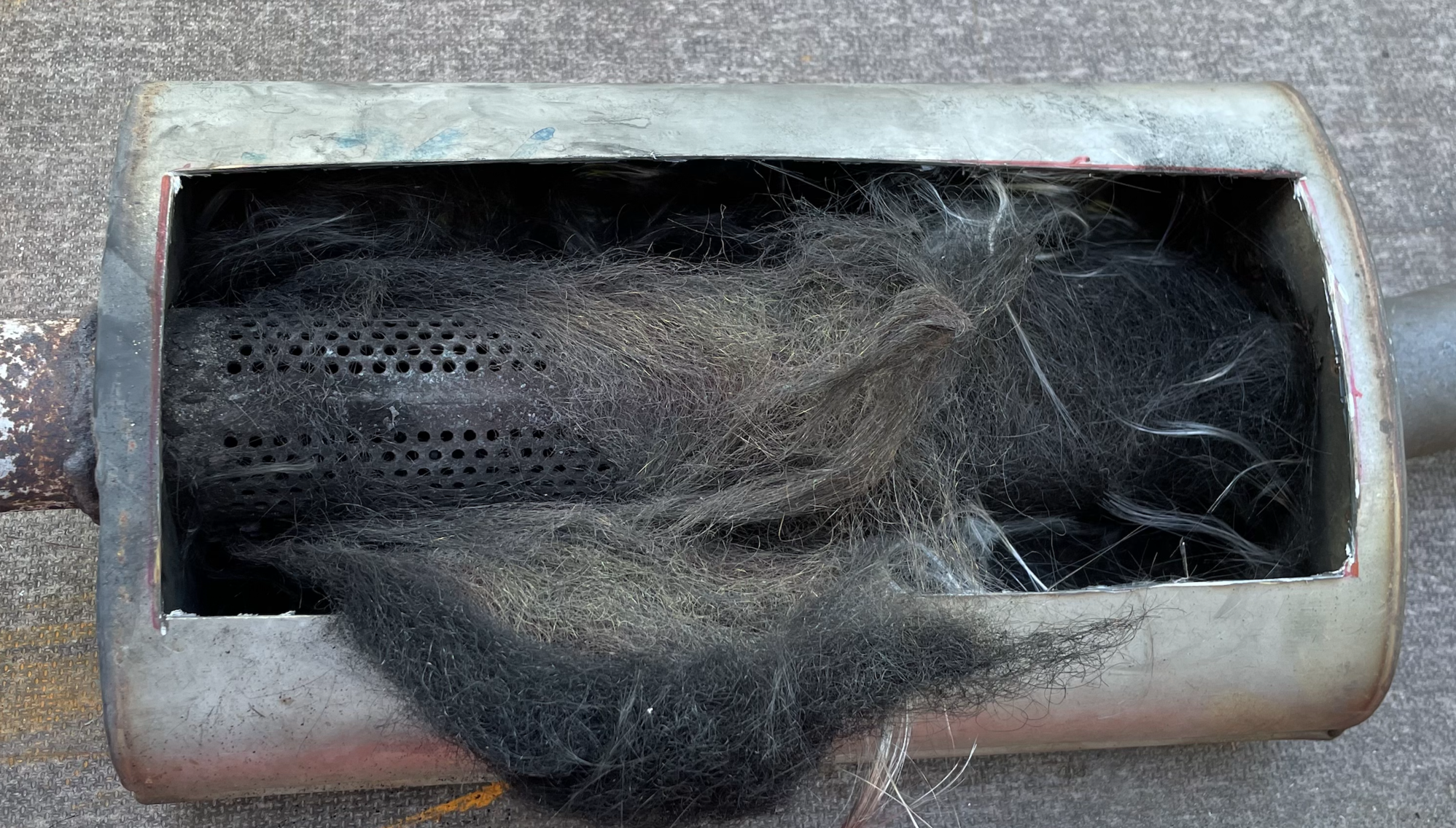

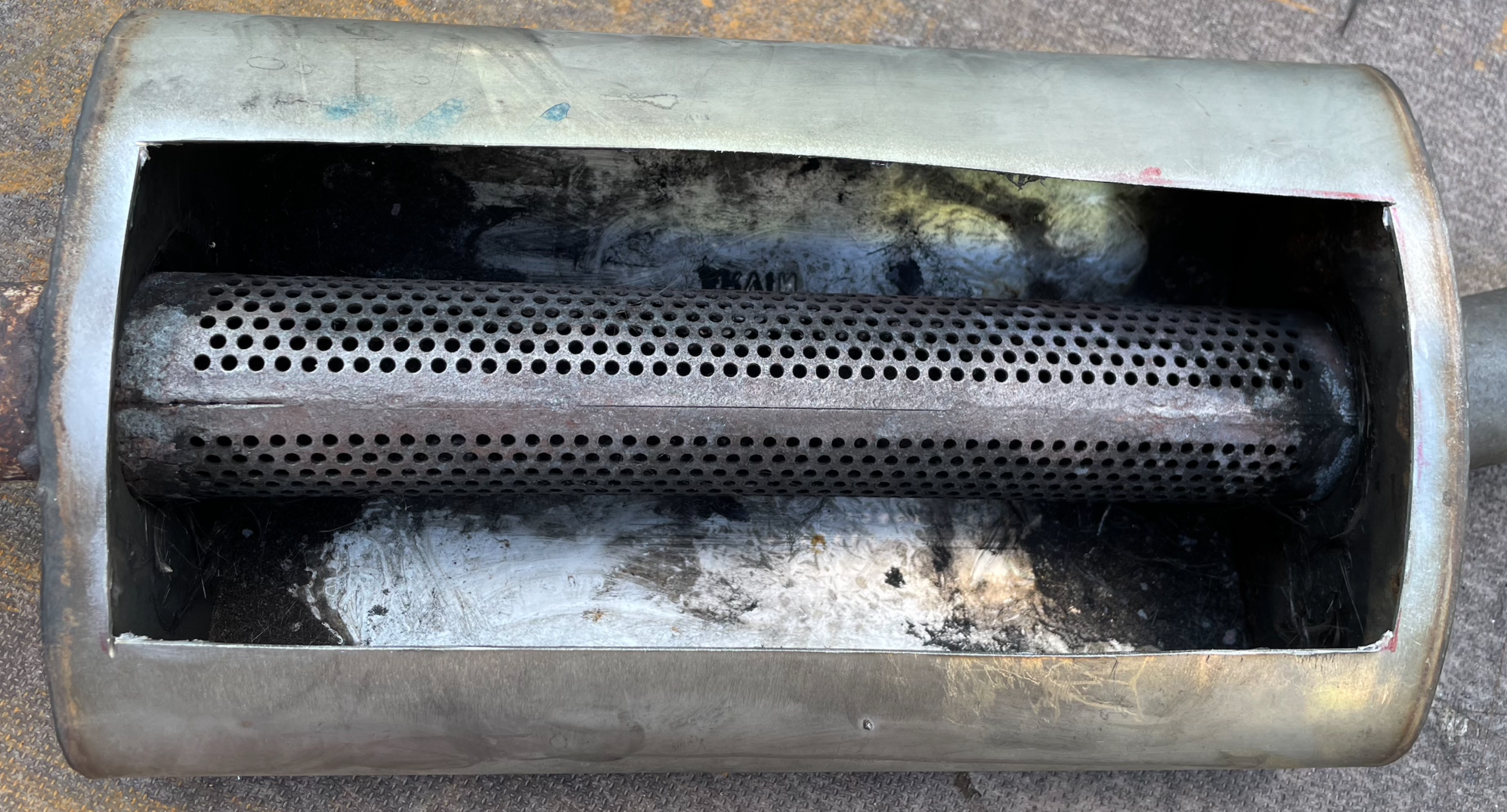

For the curious among us, as announced the cut open resonators.
I welded a sheet around the open pores of the inner pipe, curious about how it affects the sound.
Curious enough, it did not change the sound at idle at all. Only on full throttle it is ever so slightly louder (or it might even be a placebo-effect).
It seems that the pores of the pipe have a big effect on the sound, even if they are closed with the sheet around it.
Anyone knows why manufacturers choose to put all the wool in it?

Steel wool, fiberglass, etc is added for sound purposes. It helps get rid of the high pitched, annoying, raspy sound and makes it a deeper sound. It has no influence, good or bad, on performance.
Some like the sound with it, others seem to like it without.
Fiberglass matting rapped around the perforated baffle is more commonly used than that mess of steel wool and does a better job of deadening that cheap metallic sound.
Personally, I prefer a deeper rumble.
If you do a google search for exhaust wrap, you'll get an idea of the different types used.

I understood the functional principle of the resonator, but was expecting a bigger effect with the holes covered.
I am also looking for a bit of a deeper rumble and would love to archive something like this but slightly quieter:
Does anybody know what type of construction the rear mufflers are? Are they Helmholtz-Resonators, Quarter Wave Resonators, chambered or a combination of them?

I made a quick sketch in CAD to explain what I have changed. (with close to no effect on the sound level or characteristics)
Anybody with experience in exhaust tuning? I expect that the holes dimples on the inside of the exhaust as it is now, have a similiar effect as the surface of a golfball, and thus still have some
aerodynamic effect on the exhaust pulses which in turn mutes the sound despite the lack of wool.
