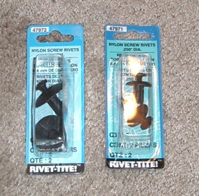

Default Plastic Wheel Arch Liner Fixings
I got these from "Pep Boys" in the U.S. Supplier "Rivet-Tite" Patt # 47971 & 47972 (5/8" Head & 1" head) 2 per Packet at $1.99 + Tax = 1.25 British Pounds.

Ah ha..... I looked up TerryR's fixing and found this suppliers info :
Dorman Motormite 47972 Body Fasteners, Specialty Rivets - Outdoor store
It seems they are a Ford part, or equiv. I thus tracked them down on ebay using the ford part no. TRIM CLIPS X 10 TO FIT FORD N804837S | eBay
Got there in the end !! Thanks Terry.

Thanks to both "steveinfrance" and "jimlombardi" BUT I was researching this item for "Nurquhar" in the U.K. who was having problems locating these. I got mine from "Pep-Boys". BUT now we all know where to get these items now. Another Jaguar Form Problem solved. LOL Thanks for all the efforts guys.
