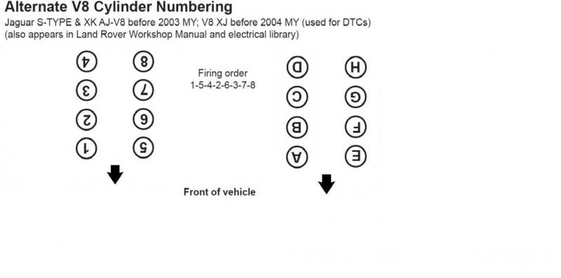

I've searched and I looked at the cylinder # diagram. I know the cylinders are numbered 1-4 on both banks. But the codes I got are P0303 (cylinder 3) and P0353 (coil C). My question is what side of the engine is that? The codes I got did not say bank A or B. Thanks for any help.

It's 3 take a look at the pdf.

Thanks for posting that Norri, but it's not particularly helpful, is it? For my car it lists two different numbering systems.

It does, but they are both the same aren't they? It just has two different ways of designating them.

Hi newuser
Here is the cylinder numbering chart that testpoint posted in another thread (I have it on my PC):
I extracted the Alternate V8 Cylinder Numbering information from Norri's Post (I rotated the image 180 degrees to be able to make the comparison easier the view):
I tried to compare this diagram on left with the other one Norri posted (Alternate V8). From Allternate V8: Cylinder numbering From Front on Bank 1 is 1, 2, 3, 4 ; on Bank 2 is 5, 6, 7, 8.
Firing Order is Bank 1 Cylinder 1 (1), Bank 2 Cylinder 1 (5), Bank 1 Cylinder 4 (4), Bank 1 Cylinder 2 (2), Bank 2 Cylinder 2 (6), Bank 1 Cylinder 3 (3), Bank 2 Cylinder 3 (7), Bank2 Cylinder 4 (8).
This gives you firing order 1 : 5 : 4 : 2 : 6 : 3 : 7 : 8
Firing order on Norri Posted is 1-5-4-2-6-3-7-8
Where is COIL C located?-v8-cylinder-numbering.jpg Where is COIL C located?-alternate-v8-cylinder-numbering.jpg
The image and the attachment are the same diagram (you can right mouse click and use save as option - to save it on your PC)

Thanks so much, Jim. I got it running good again after replacing the coil. Everyone here have been helpful and i appreciate that.

Which one did you replace?

#3. The 2nd one from the firewall on the passenger side. Got it from Autozone for $113 with a 2 year warranty. Its the exact same one OEM made by Denso.
