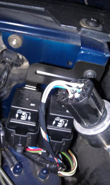

Could be a relay, there are two under the the hood up near the left of the radiator and are brown/fawn. One is run and one is park. You can pull them and swap them to see if there is a change. I would also suggest that it could be the onscreen rain sensor. These are stuck on on and if detached at all slightly, will then trigger a sweep.

You don't need to replace the relays just swap them round and spray a bit of WD40 on the connections. For some reason doing this fixes them.

I think it is fixed. I swapped the two relays and that did the trick. Sprayed water on the sensor and it started wiping. Took some pictures.
