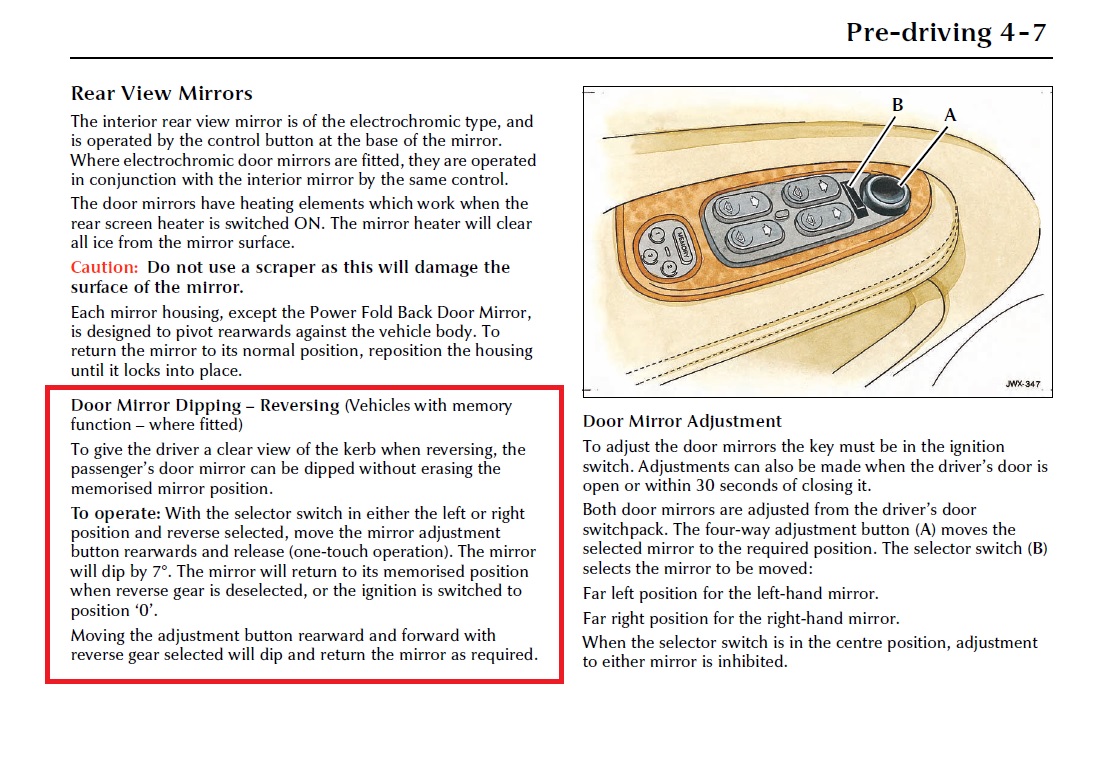

See the section I've boxed in red for an explanation of the dipping function:
It only operates on the passenger side mirror.
