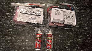

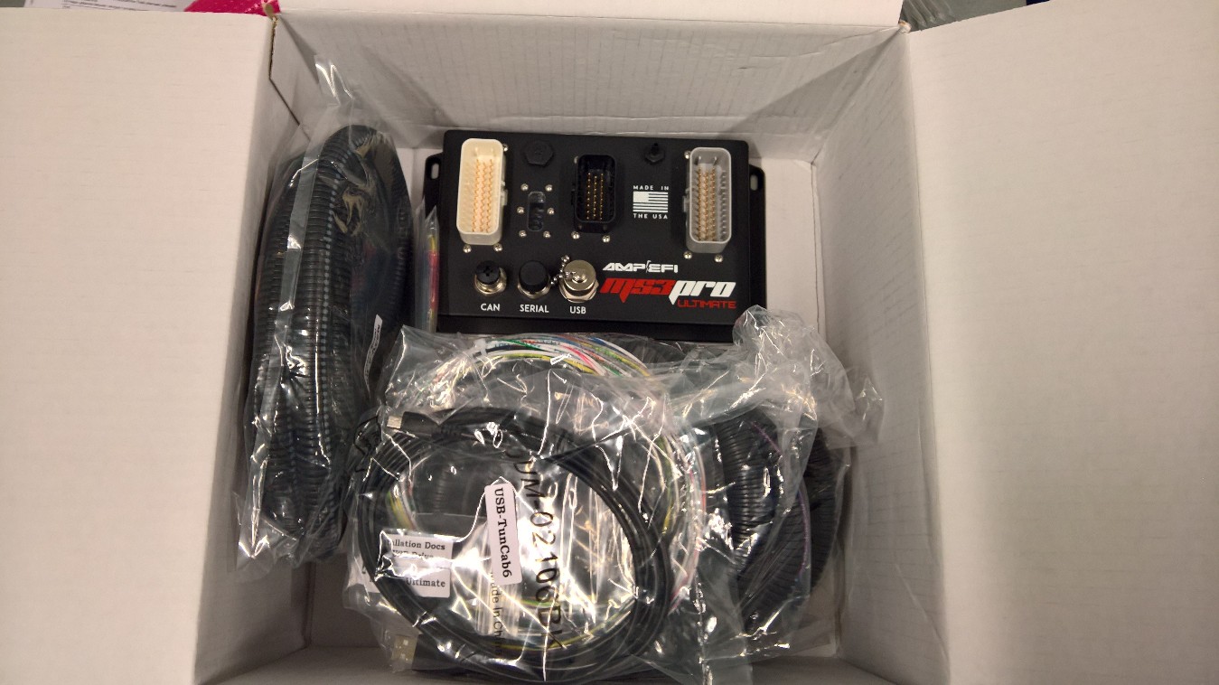

Some new stuff. 9.99 ?
WHat does that MS3 ultimate box do?
Old Nov 30, 2017 | 01:16 AM
XJR-99's Avatar
Joined: Nov 2011
Posts: 878
Likes: 324
From: Europe
Controls the engine.

Here's their site Count.... https://www.ampefi.com/
XJR...is that the 24x or 58x you have?
Does it replace the Denso ECU (stand alone) or is it a piggy back?
From how I've read it, its strictly a stand alone, but XJR, Sean, greverrr or Waterdragon would have to confirm that. My sentiment is it performs somewhat similar to the FiTech on my Corvette.

Megasquirt is standalone and the name “standalone” speaks for itself (it can run your engine totally by itself).
With standalone generally what it entails is junking your factory ecu then taking those wires (engine management aka fuel inj, coil packs/ignition, knock sensors, cam/crank sensors, upstream O2, MAP/MAF, ect) and soldering them accordingly to whatever standalone system you may be running.
With some popular cars where standalones are frequently installed you can order plug and play harness’ to plug right in, generally speaking that is not the case for a Jaguar. Good old cutting and matching up wires will do the job most likely. From my experience OBD2 ECU’s for modern engine management are usually 50-70 wires and you surely wont need them all for megasquirt
