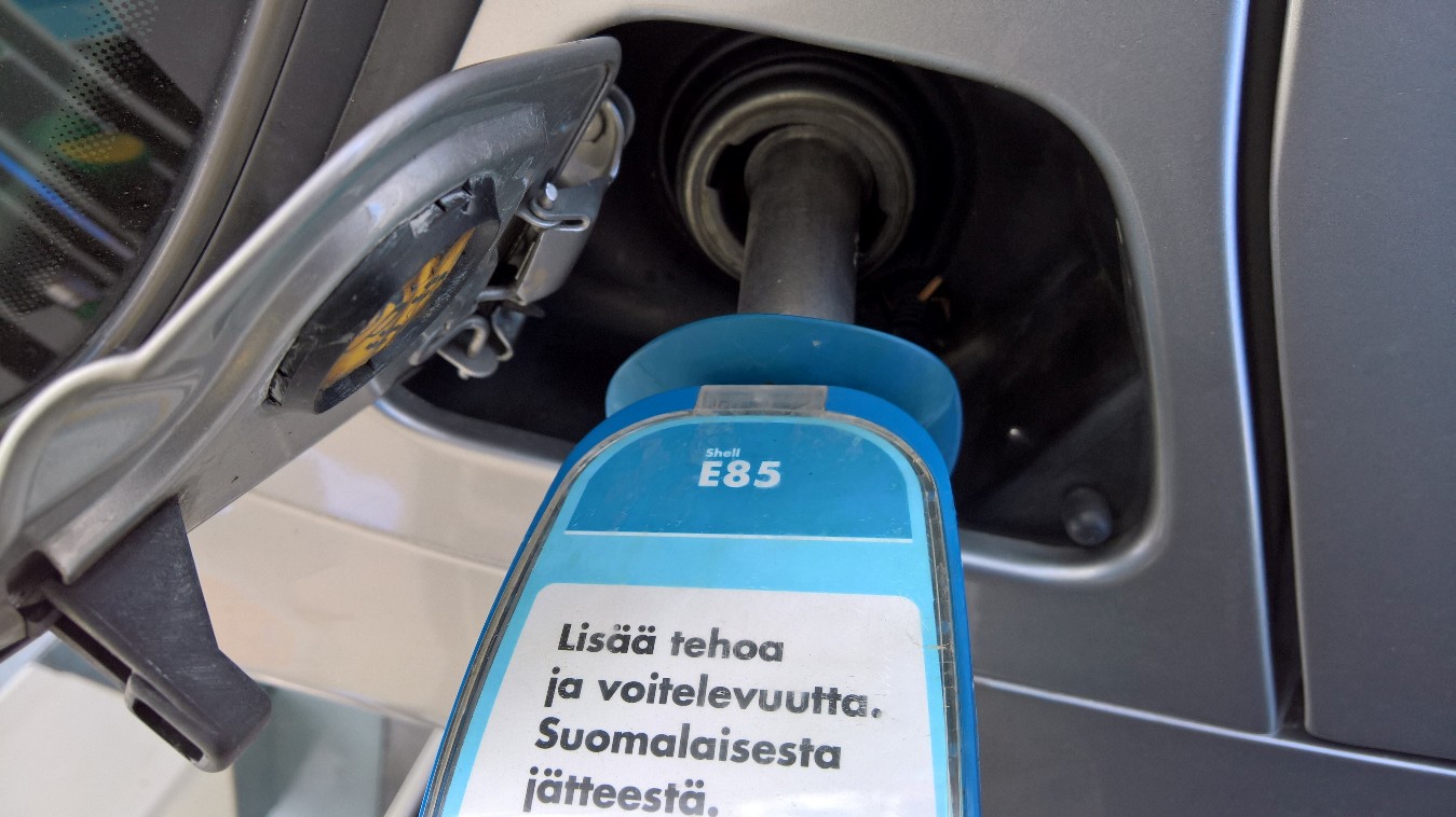

Today first time E85 into the tank. Measured ethanol content was before the fill up 5% and now 41%. It's good to test different blends before straight E85 ( still winter blend here ~70-75% ).

what kind of performance gain do you think the E85 give? In the Bugatti Veyron it's 17%!
I would say ~3% without special E85 tune with much more timing. E85 mostly because I want to avoid detonation possibility. My car is flexfuel, so ECU is adjusted to change injector pulses based on ethanol content. Looks like it works well. It's important to use proper oil, Redline alcohol stuff into the tank and E85 graded injectors, fuel lines and rails. Also fuel filter is good to be changed after a couple first tanks.
