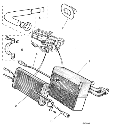

Actually the one I have been replacing twice and that keeps me giving the error No 15, is the one next to the heater matrix: part number 3 in the attached picture.
