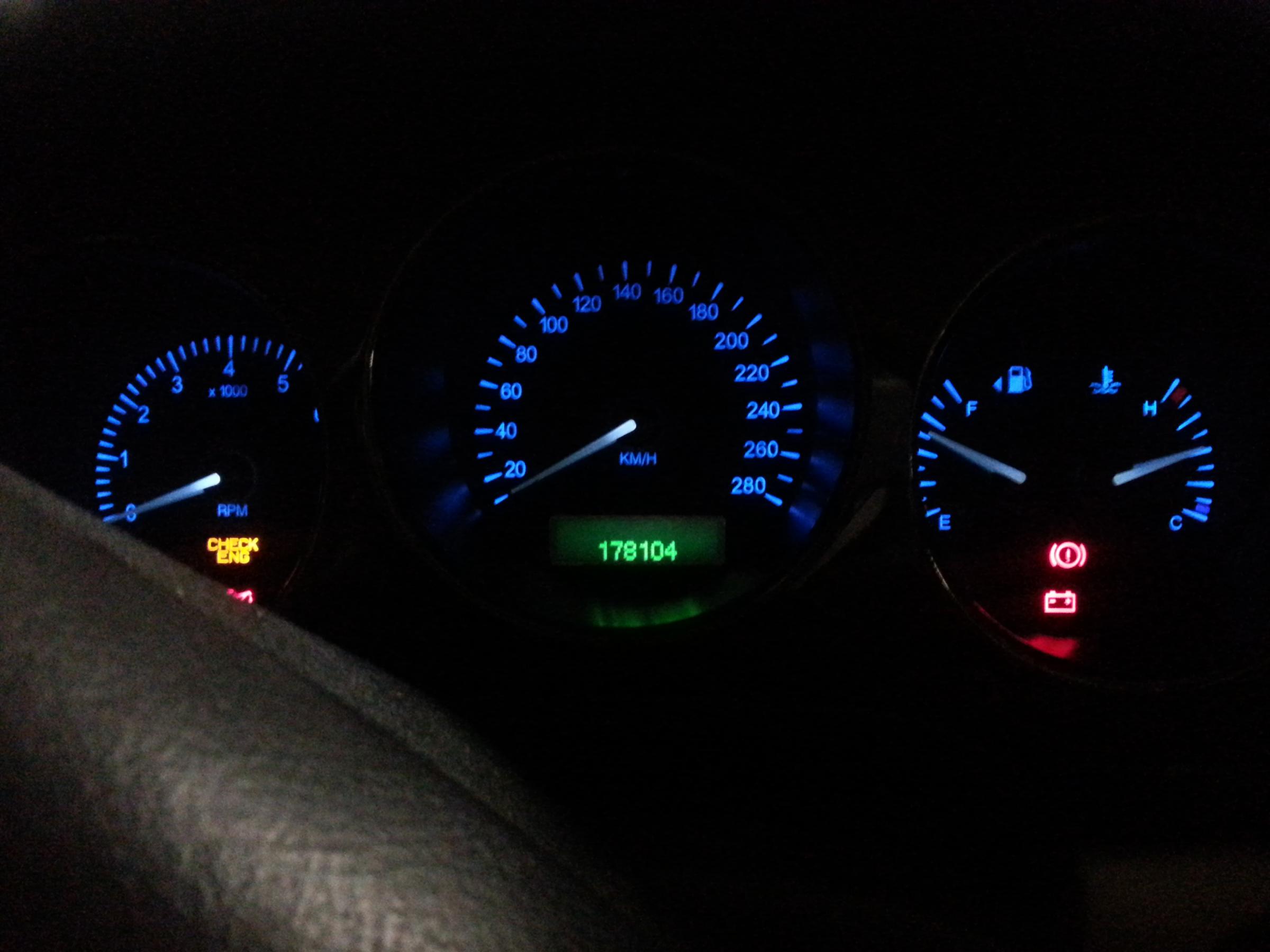

I can help on the instrument pack front. I bought the 'T10 6-LED Flat Style' in white from BI LED Australia. Was about AUD$30 for 8.
I whacked four of them in the instrument pack about three months ago.
They look like the attached.
I'd have preferred pure white to be honest, ideally with the needles in red. But I'm sure that'd involve taking whatever colour filters are in there out, and I'm not quite sure that'd be worth the heartache involved.

Try that again!

Thanks for doing that for me. I appreciate it. On the posts I have read people prefer the white LED's as the dash already has a tint. So all the instrument globes are standard T10's. Too easy..must have been the X300 that had T5's maybe..Would you still have the link of where you brought them if online?
Yep, I bought them from: 6-LED Flat Top (Spread) : BL LED Optronics, Light up with LEDs!
Couple of issues though:
1) They don't seem to have the white colour anymore. That wouldn't be too much of an issue - any of the other types from T10 194 168 LED Bulbs : BL LED Optronics, Light up with LEDs! and indeed a few other options on the site would work just as well.
2) On the front page on BL LED's site it talks about a relocation and not being able to process any orders. This was due to have been rectified last month, so you could always give it a go, but it may not process right now. I know there's other stores online, but I was keen to give an Aussie one my $$.
If I recall correctly, there were a number of smaller bulbs on the back of the instrument pack, but I didn't replace these. They're for lighting up the warning lights on the gauges, but I always found these to be bright enough.
