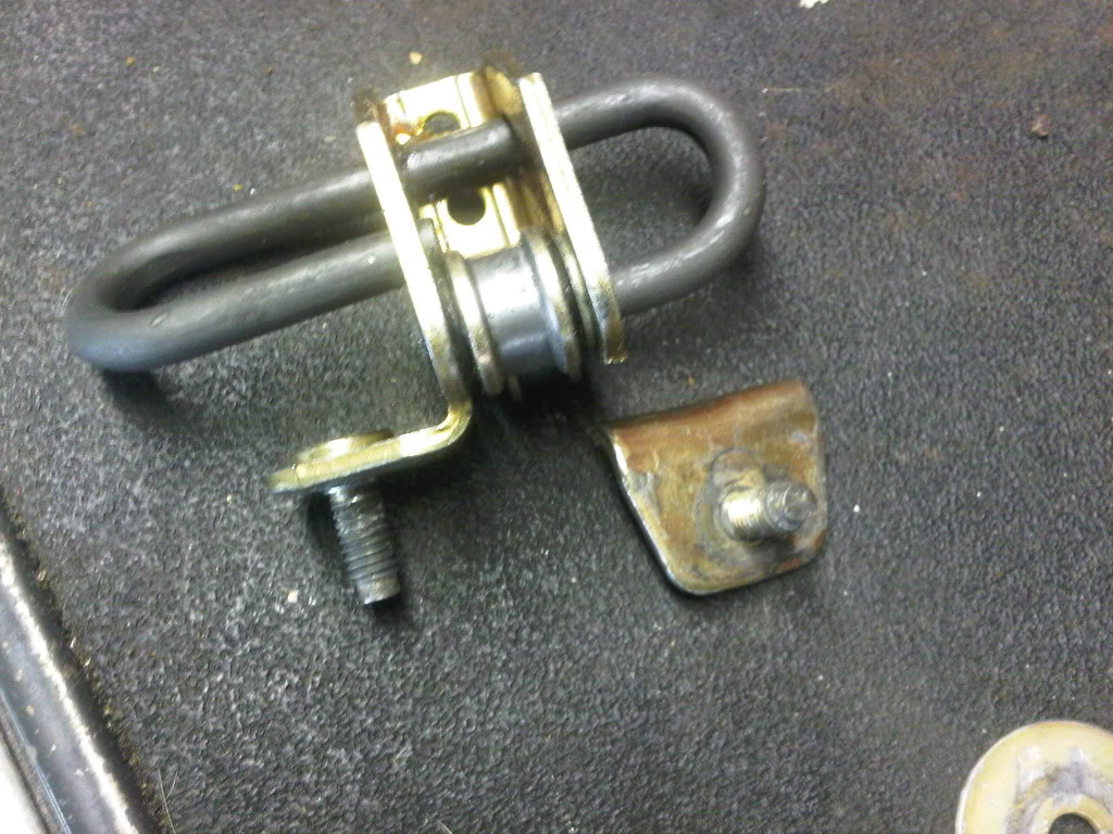

Update- remember that cracked assembly? And how I thought it'd be ok?
Wrong.
It snapped this week. I robbed the one from the left rear door to keep the drivers door working ok until I get another one. Also, one of the nuts was loose, so use Loctite, or like me, put Nylock nuts in there.

Old Oct 4, 2011 | 06:16 PM
plums's Avatar
Posts: 9,733
Likes: 2,203
From: on-the-edge
Exclamation more info please ... in the middle of the job
There is a pin at the nose of the checkstrap that goes through the A pillar bracket.
The pin seems to have a screwdriver slot.
But ... it does not seem to want to turn.
Is it in fact normal thread? Reverse thread? Press fit?
JTIS is completely silent on removing the bracket from the strap.
BTW, the bag says "Made in Germany". Well, standards must have really taken a nosedive. Especially for what these things cost.

Lightbulb A pillar bracket pin removal
Removing the pin is not a problem.
Ignore the fact that it has a screwdriver slot. The shaft is not threaded or splined.
It presses out with light pressure using a c-clamp and small socket to make a recess for the head.
Once the threaded end is flush with the face of the bracket, pull on the head at the other end and the pin will come out the rest of the way.
With the arm removed, a bolt and nut with a stack of reinforcing washers is a dandy way to pull the metal back into alignment. Just put a couple of washers on each side of the sheetmetal and tighten the bolt to flatten the sheetmetal that has been deformed.
