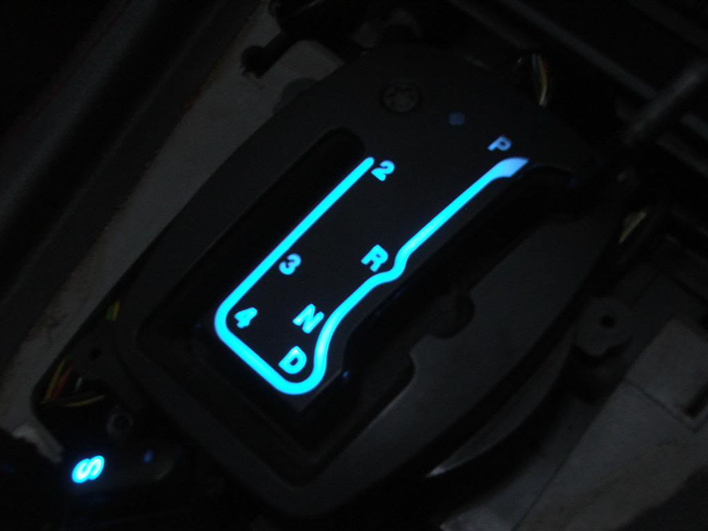

I've done a complete led update to the interior and there's a few that require soldering.
The bulbs that can be replaced by twistloc types are:
climate pack
IPK (inst cluster)
Door window packs
The J gate is a solder job, as is the radio console.
I soldered all of them inc resistors, i won't need to replace any for 100 years!
