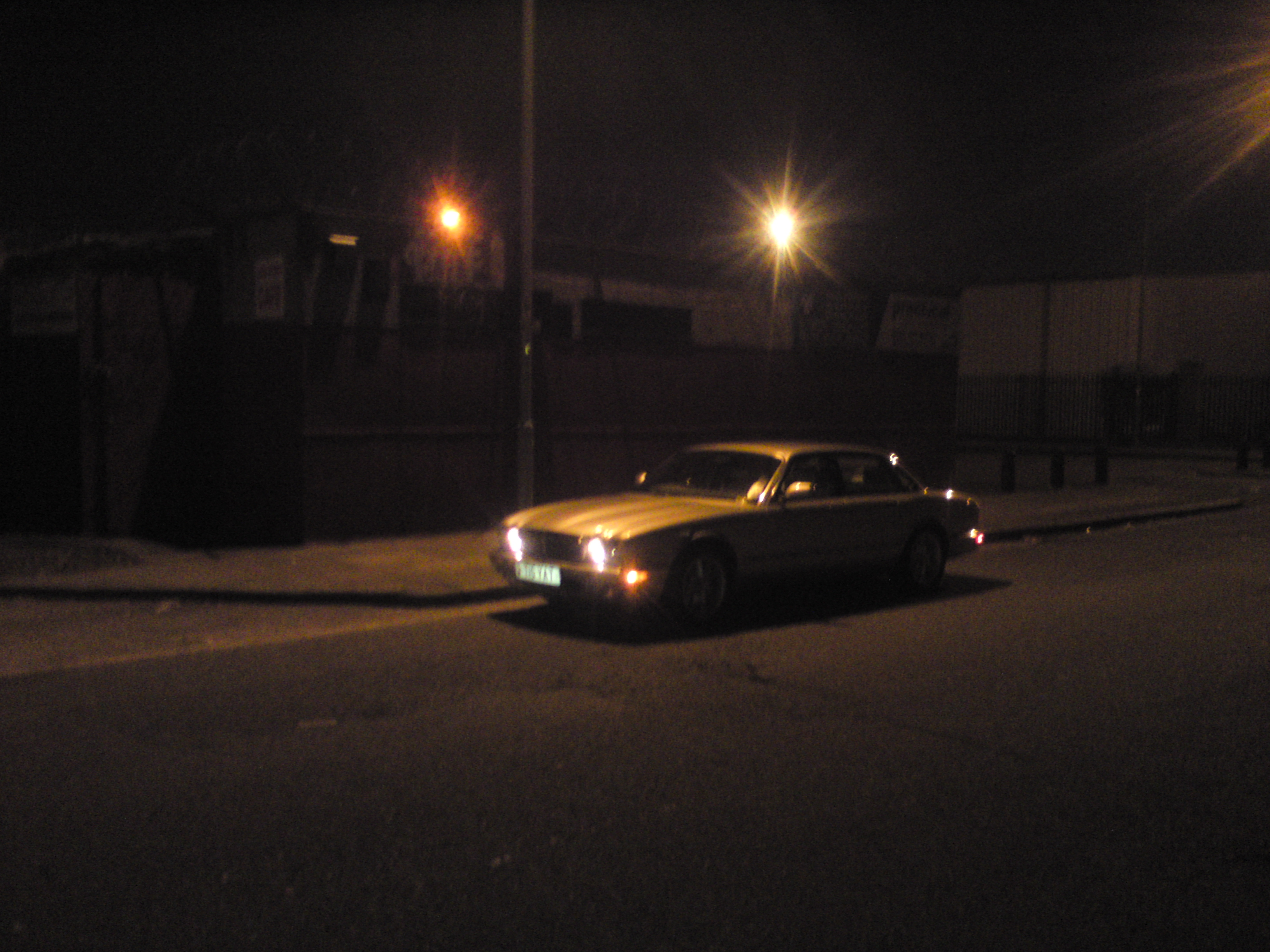

I've found a rather shaky photo I took of my old 99 car with the side markers lit, they do look good in my opinion.
Hard to tell from the photos for certain, but if you have state safety checks and if your front side markers and turn indicators are actually red, you are likely to be failed... or if you drive down the road with lit red lights on the front of the car you may receive a citation.
I'm not familiar with your state's MV laws, but all states I'm familiar with outlaw civilian vehicles from displaying a red lights on the front.
That's a sharp looking white on the car BTW
I think as long as they still glow orange they should be fine
