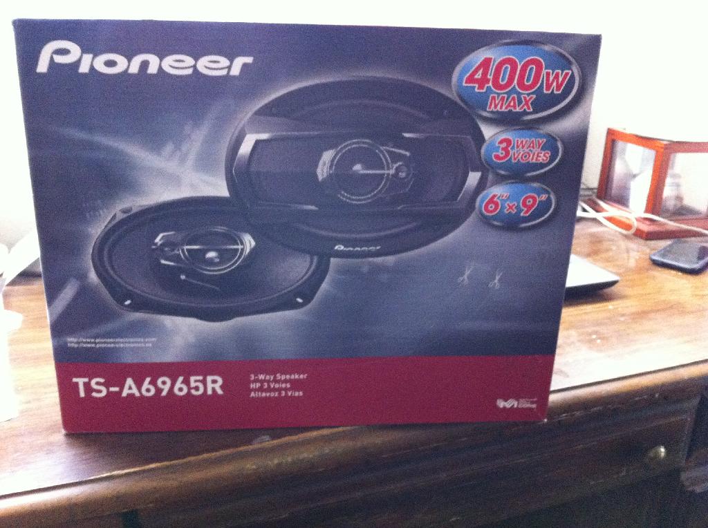

Replaced the old "sub" with these:
As we only have one I have an extra one and well sell it for $40 shipped. It sounds really good when I tried it out with Crosby, Stills and Nash, London Grammar and Midlake but lacks real bass for rap.

The 6x9 speaker in these cars use a dual voice coil. (Gives bass from both left and right channels. Single voice coil speakers will only give bass from one channel.) Dual voice coil speakers are usually sold individually.

Hmmmm, I had n o idea you could replace a dual cone subwoofer with a single cone and it still work

It should work as long as you match the impedance

What low frequencies do you think this 3-way speaker is able to faithfully reproduce? The mid and high frequencies that it can reproduce are already addressed by all four doors’ speakers and tweeters, including the A-pillar ones. Then, the original XJR subwoofer is a single, low frequency-only optimized cone driver that, most likely, a 3-way “all frequencies” speaker will not match. Furthermore, even with the OEM unit, I don’t believe that the designers of the XJR “Premium” ICE were expecting their 6x9 driver to truly reproduce frequencies into the lower than 100 hertz range. Then, I have some pieces of music moments, like pipe organ and such (try the very end of “Vesti la Giubba” from “Pagliacci” that can likely crack the walls if enough volume…LOL) which can explain the simple difference between a subwoofer and a…woofer. At low enough frequencies, one reproduces the sound, the other one reproduces…silence. I learned this a long time ago when I cut two big 12” holes on the metal behind the rear seat that divided the trunk and the passenger compartment on my ’77 XJ12 in order to install two 12” “free-airs”. Man, what an incredible difference this made. The really low frequencies sounded massive, so very broad like coming in from all angles, like coming from a very large and high ancient Egyptian palace. A small cone couldn’t possible emulate that experience.
This is why I have dedicated sub woofers in enclosures, in both of my Jags (XJS). Not for “boom-boom”, but rather for great low frequency music support. I would highly recommend this route to true low frequency response.
