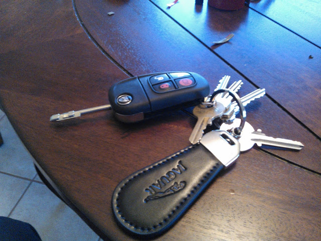

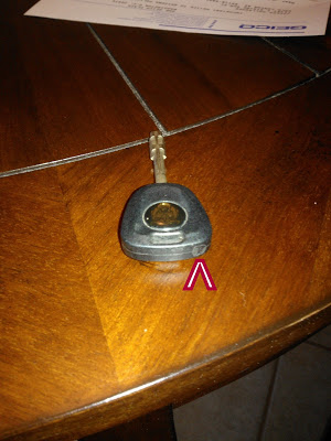

First order of business was swapping the transponder chip. My original 2003 key had a Megamos chip whereas the switchblade key had a Texas Instrument chip. Note the oval outline in plastic on the top edge of my 2003 key in the following photo.
The transponder chip is embedded under this area. I carefully cut the 2003 key with a hacksaw and cracked it open to expose the tiny pill shaped transponder. I then carefully cut around where the tibbe blade meets the plastic portion of the 2003 key and separated it as well. It will look something like this:

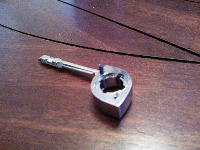

Next, I separated the top half of the switchblade key (see photo 4). This makes swapping the transponder chip and removing the roll pin much easier. I used a small nail to push out the roll pin. Once the roll pin is out, I removed the uncut tibbe blade and inserted my original cut blade. The portion of the blade that is inserted into the switch blade mechanism will need minor tweaking with a hacksaw and a file to make it fit properly. I also duplicated a small indentation(see photo 2) in the blade to allow the roll pin to seat correctly. I pressed the roll pin back in using my workbench vice.

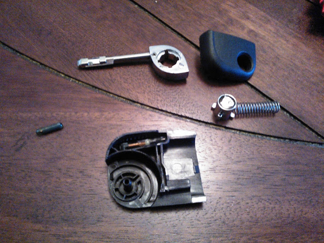

In the following photo you can see all the separate pieces. You can see my 2003 pill shaped chip on the left side of the photo. Also note the chip (copper color) that came with the switchblade key and where it is positioned in the plastic housing. I swapped the chips and layered some double sided tape in the housing for better insulation. From there I snapped the pieces back together. It takes a little practice to rewind the spring and hold everything together.

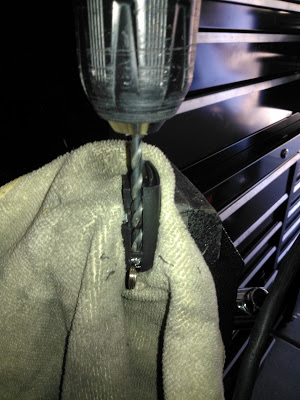

The X308 uses a longer 8 cut tibbe key whereas the switchblade is designed for a shorter 6 cut key. I had to remove a small bit of plastic to make the key fit properly in the closed position. I used a combination of a drill, a knife, a file, and a soldering iron (to finish the edges of the plastic).

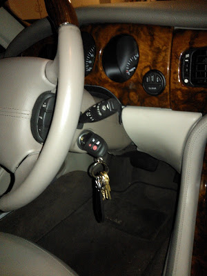

Finally, I programmed the keyless remote using the following instructions:
1. Pull and hold the headlamp stalk towards the steering wheel (activating the high beams).
2. Turn the ignition to #1 position.
3. Flash the high beams 4 times, car will chirp.
4. Press any button on the remote[s], car will chirp again.
5. Switch off the ignition.
There you have it…the car starts and everything works properly.
