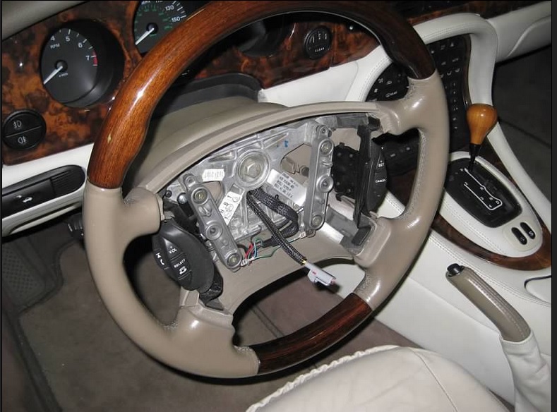

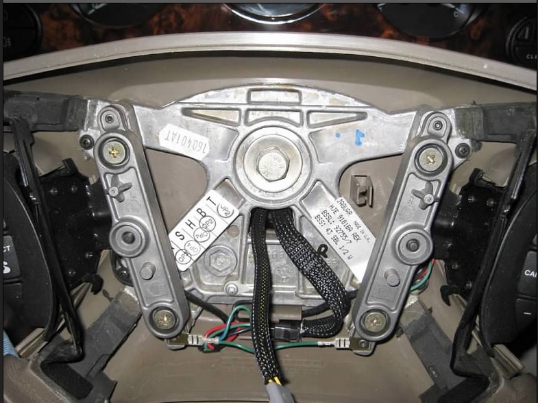

Here are the photos that member IvanG made for removing the Steering Wheel components to replace the clockspring:
Here is the list of components per jaguar classic parts website:
Jim Lombardi
Attached Thumbnails XJ (X308) Windshield Wiper- Washer Switch R&I-photos-steering-wheel-removal.jpg   XJ (X308) Windshield Wiper- Washer Switch R&I-jaguar-xj-steering-column-lower-upper-shrouds.jpg   XJ (X308) Windshield Wiper- Washer Switch R&I-xj-x308-steering-wheel-diy-photo-1.jpg   XJ (X308) Windshield Wiper- Washer Switch R&I-xj-x308-steering-wheel-diy-photo-2.jpg   XJ (X308) Windshield Wiper- Washer Switch R&I-jaguar-xj-x308-steering-column-switch-parts-list.jpg
