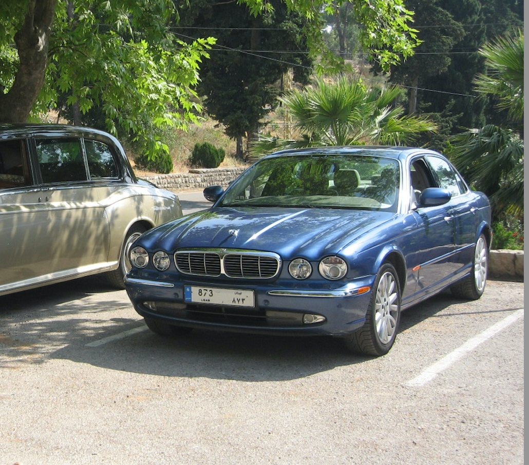

But I just realized my car is X350 so there may be differences in the technicality of the locks and I will need to dig into my case a bit more to see if I can fix it.
My only issue is if anyone drives the car and not aware to unlock it before switching off, the opening lever will override the locking lever and will keep the door locked until one of two things are done:
1. Hold the locking lever in the open position and at the same time open with the outside lever simultaneously, or
2. Remove the side wooden strip and pry the opening lever back to its correct position.
Somehow I feel this problem is related to a relay somewhere either in the car or the lock itself which is failing to give an order to the lock to unlock itself when we park and switch off.
Now that I aim to spend "quality time with this car after abandoning it for 5 years, I will get to the bottom of it....hopefully
It is still in empacibble condition and a true pleasure to drive. I had forgotten how powerful the engine was
. Photo belowThanks for sharing your views.
