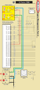

Listen for the fuel pump to turn on for 3 - 5 seconds then back off as you have the key in the run position only . It will turn back on after the ECU sees rotation . If the pump does not turn on you can jumper power to the relay power side out socket from the B + terminal on the battery . This would put power directly on the pump . Use a blade type connector on the relay socket as this is high current arcing hazard to the socket and the last contact on the battery . There is a relay and a fuse located electrically after the relay . The relay my be pitted on the power half contact not allowing enough current to drive the pump . You only have a # 1 fuel pump on a non = supercharged engine . You can swap relays with Jaguar # LJA6703AA superceeded by ↳ C2P11192 found at the local auto parts store same as /
+ accessory socket
+ air conditioning
+ fuel pump
+ ignition/engine
+ ignition/heelboard
+ powerwash
+ seat heater
+ Other Option
+ Rear parking aid
You can try the fuse and relay before rolling across the shop door and be charged .
Something still funky about your electrical supply . The auto part store will test the alternator for free as they want to sell you the repair parts .
Attached Thumbnails XJ8 won't start, loud noise coming from starter-x308-fuel-pumps-ntitled.png
