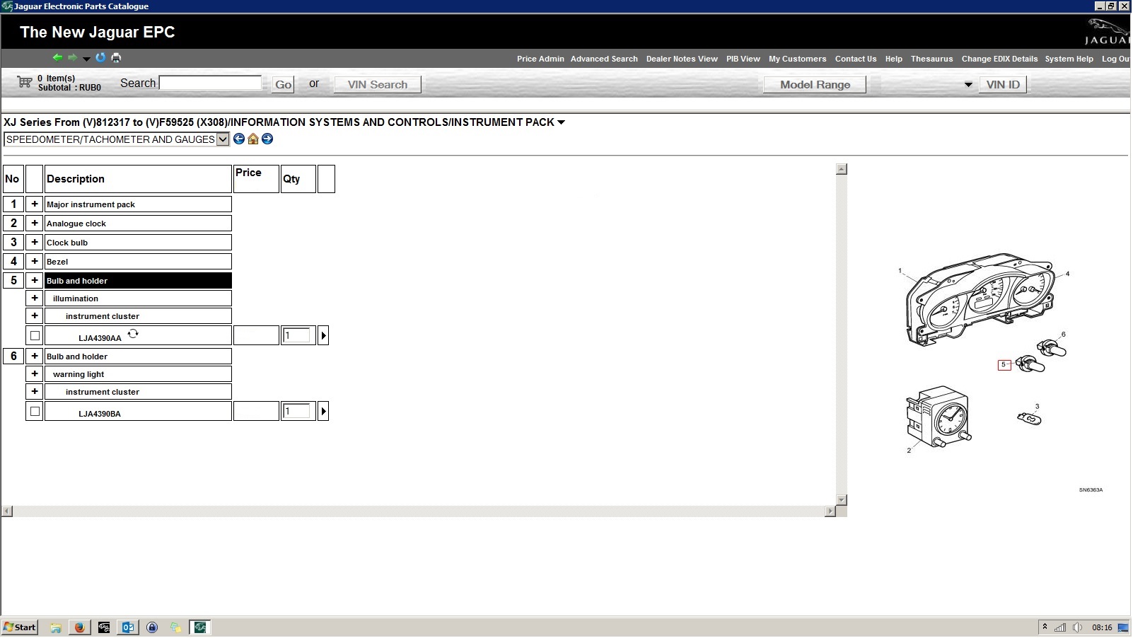

Old Jul 14, 2015 | 02:19 AM
Likes: 17,016
If that isn't the cause then check the bulbs.
The Instrument Pack has to be removed to access the bulbs.
