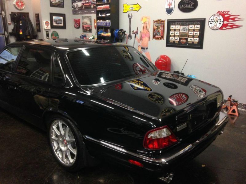

here is a pic

You have all the correct XJR-100 bits and pieces and I really doubt that someone would have spend the money, over $20K for sure, to add them to an XJR.
Just remove the carpet trim and take a couple of pictures of where the amp, CD and Nav module is/was.
There are some little things that will tell me if the nav was removed or not
