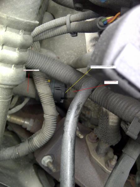

hi everyone i have a slight leak it seems to be the heater hose however the hose is dry but where there is a black plastic connector/adaptor it seems to be wet and dripping out of there
i am trying to attach a picture sorry you may have to zoom in to read what i labelled i apologise i have forgotten how to post a picture on here properly
is there anyway of getting the adaptor/connector on its own or do i have to buy the whole hose etc

Theres a oring seal in ther. And ive heard of people cutting it off and refitting. But really! Fix it correctly with a new heater hose matrix. Its a pia but if thats leaking the hose splitting open will be soon behind and that wont be a leaker but a gusher. Leave the reservoir cap loose to not build pressure and make it worse till you get to it.

thanks brutal yes i'm going to get that pipe changed iti s item number 6 on the pic attached sorry you may have to zoom
do you know what the book time is to do that job is it about a hour or more? i also ordered a gallon of the pink coolant hopefully all goes well

yes 6, take off the throttle body for better access and 3+hours depending

Had the same problem. The Norma connector fell apart as I tried to disconnect it. Cut out the connector and spliced in some heater hose with male-male connectors. There are descriptions of this on the board.

exactly it seems to be the connector its leaking out from, the rest of the hose seems dry thanks i will have a look for that thread at £70+ just for the hose and then 3 hours labour or so i would ideally like a repair but thinking after 12 years i think that rubber hose maybe a bit weak too its also a shame they dont sell that connector on its own...think its best i just put a new one least that hose will be ok for the next 12 years i hope
