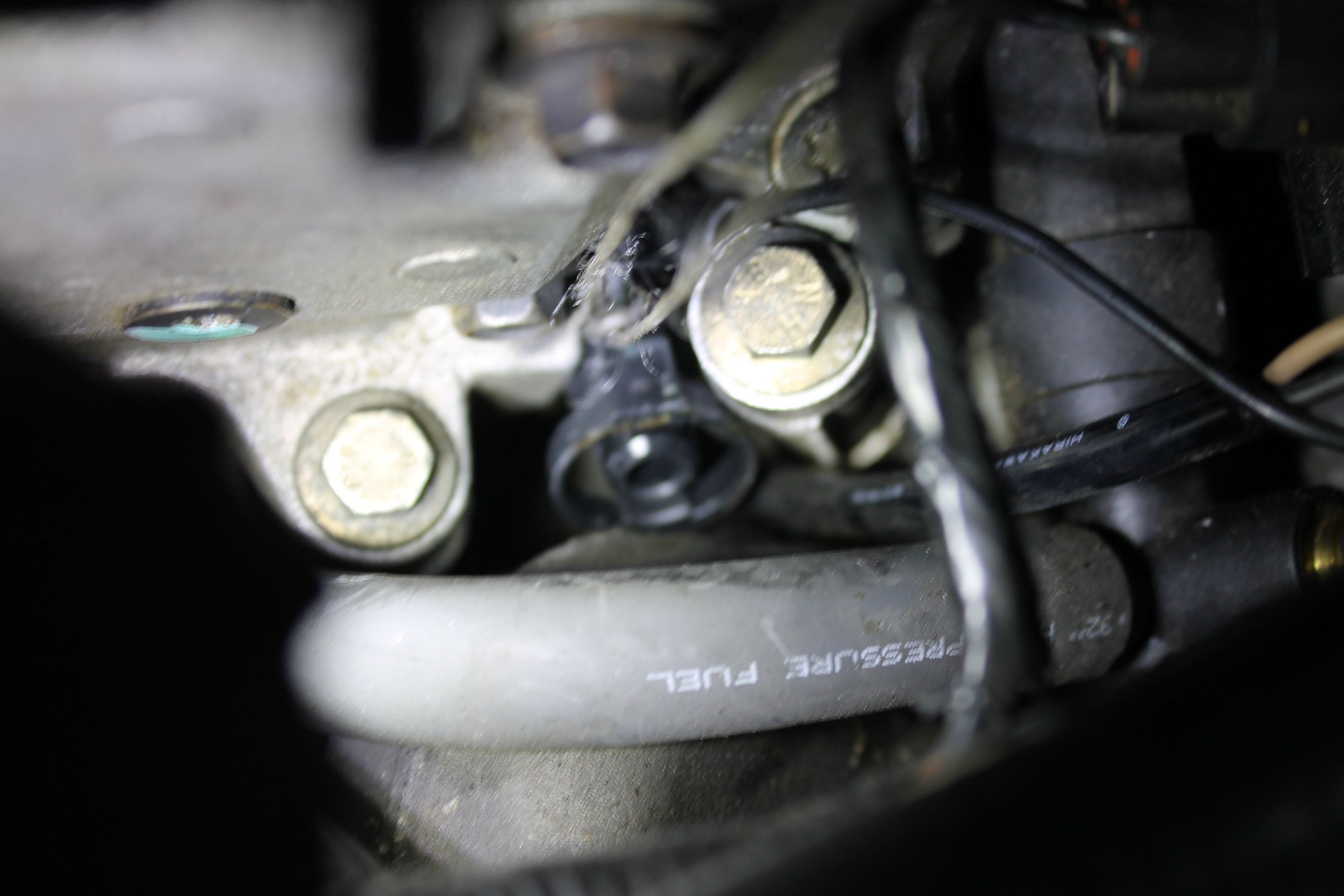

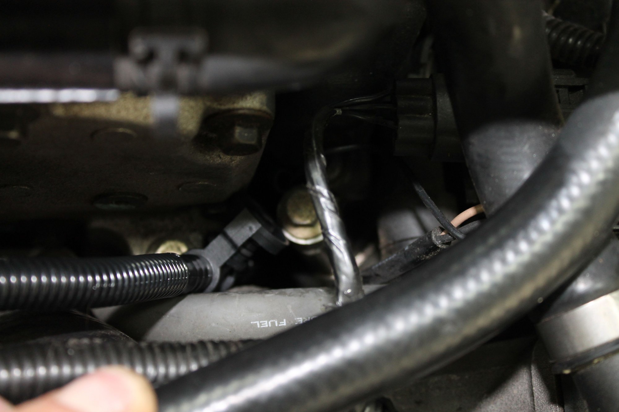

Any tips on getting this routed up to the valve cover from below the intercooler and blower? The first pic is feeding the tube front to back with the throttle body T encountering obstacles. The second pic is feeding the tube back to front, which is the reverse of how I removed the original. You'll see the valve cover fitting hitting the blower casting on the left, the intercooler casting on the right and a coolant casting forward. I manipulated the fitting to get it as vertical as possible but still no luck. It's almost there but I don't want to force anything and compromise the new tube. This is the area where the tube runs on my wife's XJR, and I don't see any other routing possibilities. Thoughts from anyone who's done this will be appreciated.

Anxious to get the beast back on the road so pushed forward and got the fitting through the obstacles without incident. Fortunately fresh plastic is a bit more compliant than plastic that's been cooked for years.
