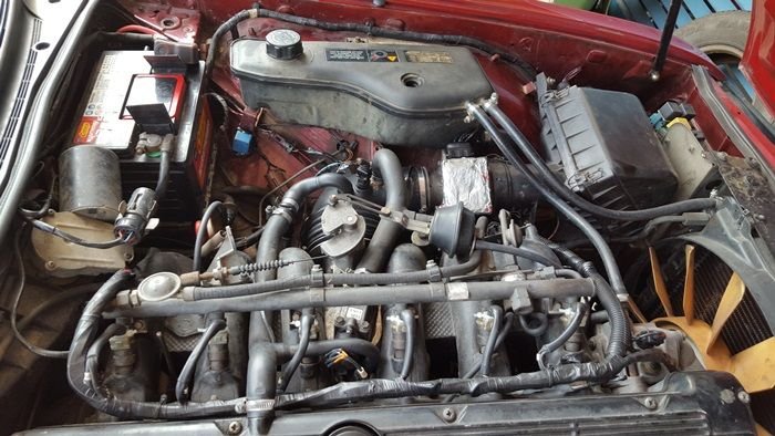

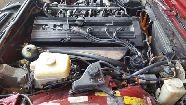

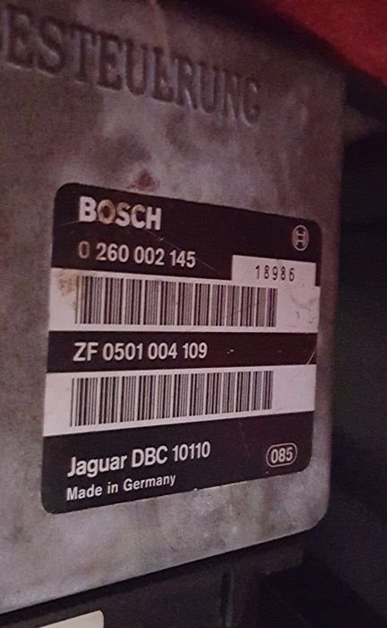

i have 89 daimler which is having an idle issue after warmed up . starting up the engine no issue at all .. its just that after few minutes of driving , on idle ... the timing will go up and down... from 850 to 500rpm... and black smoke comes out shows that its running rich , it might stall once in a while ... and it will go back normal and comes back in a while . what could be the issue here ?
i have :
cleaned the throttle body and MAF , replaced air filter , checked for loose connections and so on
havent replaced any parts yet .
i was trying to check the oxygen/lambda sensor but i couldnt find it , the 89 model dont have it ? or the previous owner removed it ???
all tips are appreciated , have attached pictures of the engine and ecu

Just a suggestion - does temp gauge come up to "N" after warm-up?
One cause of rich running is a failing temp sensor or stuck thermostat. Worth checking out, not too expensive to swap.

Not sure but I think all the cars do? it's located in the exhaust pipe just past where the manifold pipe goes into one pipe from two.

After searching ...i cant find the o2 sensor on my 89 jag.. checked from the manifold up to the split section tail pipe all the way back ... but i noticed a new stainless steel pipe on the centre.... can anyone send me a photo on exactly where it is ? Mine is 3.4cc . 6 cylinder. 89 model..

As far as I know, a 1989 model year XJ40 would have either a 3.6L or 2.9L engine. Later model years were equipped with 4.0L or 3.2L engines, or the 6.0L V12. I don't recall ever hearing of a 3.4 Litre engine in an XJ40.
In some countries the exhaust systems were not fitted with catalytic converters, so it is possible they were also not fitted with oxygen sensors. If you live in Selangor, Malaysia, you may have to do some research to learn how your Jaguar was originally equipped.
BTW, I believe the ECU in your photo is the Transmission Control Module (TCM), not the Engine Control Module (ECM).
