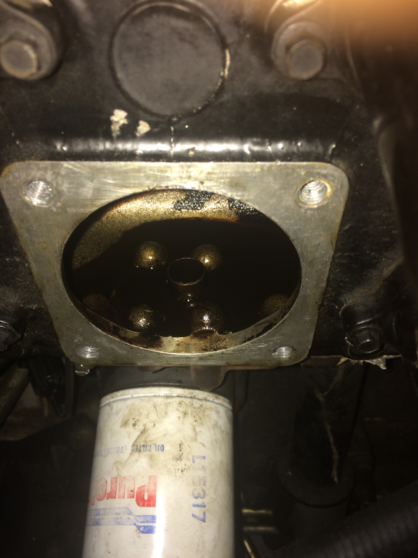

I took your suggestion and a bit further, took the throttle body off. The throttle plate is set just to where I can see light round the edges. So I Think that's fine. I am not ruling out the TPS yet but inside the manifold I found a good 2 to 3 ounces of dirty gas laying in the low spots. I was planning on doing a temporary block off plate for the egr tube but now I will wait for further comments on wether or not there should be pooling gas in the intake and which fuel pressure regulator might be to blame!

That fuel in your intake manifold could certainly be coming from the FPR if its diaphragm has failed and it is allowing raw fuel to be inhaled into the manifold.
