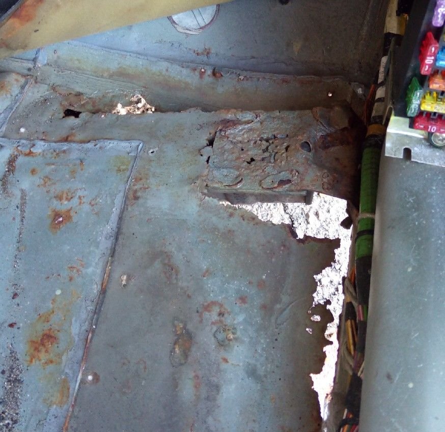

After looking it over for a few minutes and speaking with the owner for maybe a half hour or so I got into the car and drove it from Long Island NY to Youngstown Ohio. The car was very cheap and came with a bunch of spare parts in the trunk. On the trip home it drove quite well except for a lot of wind noise coming from the passenger’s footwell. I knew the car was rusty but this evening I pulled back the carpet that was covering a VERY large unsightly lump in the passenger’s side front floor.
Lump in passenger's side footwell from pushed up jack point
After I removed the riveted in patch panel I found this hole in the floor. I managed to move the dislocated jacking point back down into place so tomorrow I can try to fabricate a better patch for the floor to eliminate the wind noise whistling through this hole.
Rust hole in passenger's front floor

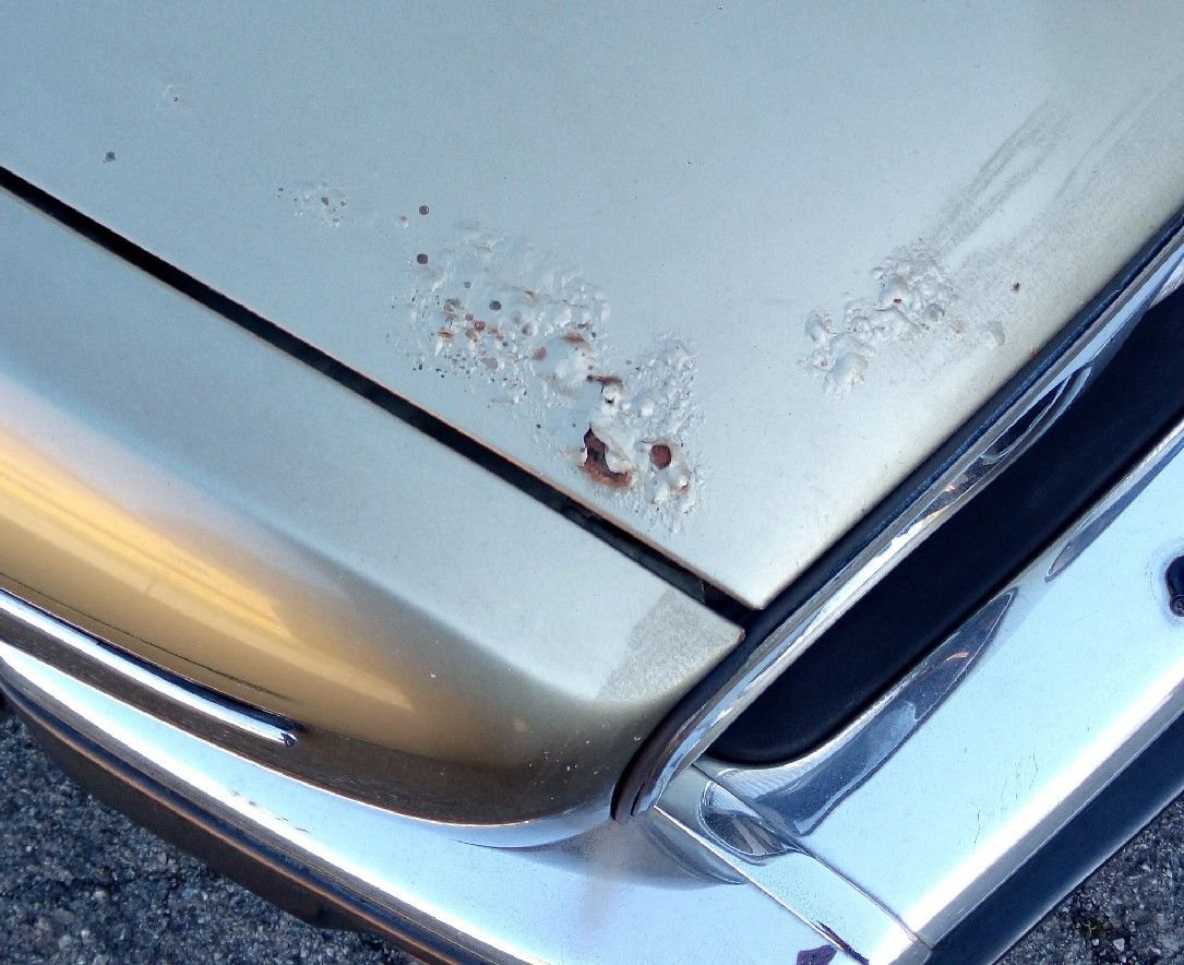

This are also rust bubbles on a few spots of the hood.
A few different spots of Rust bubbles in hood

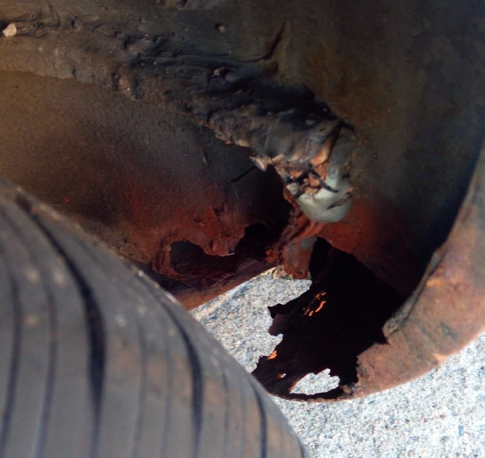

Rust in rockers

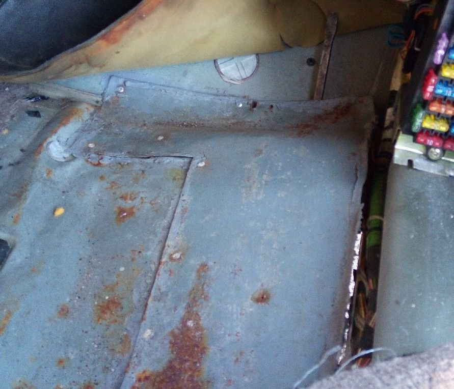

Default Cutting bad rusty metal out of the passenger's side floor
Working on cutting out the rusty thin meal in the passenger's side front floor this evening
Still more to cut

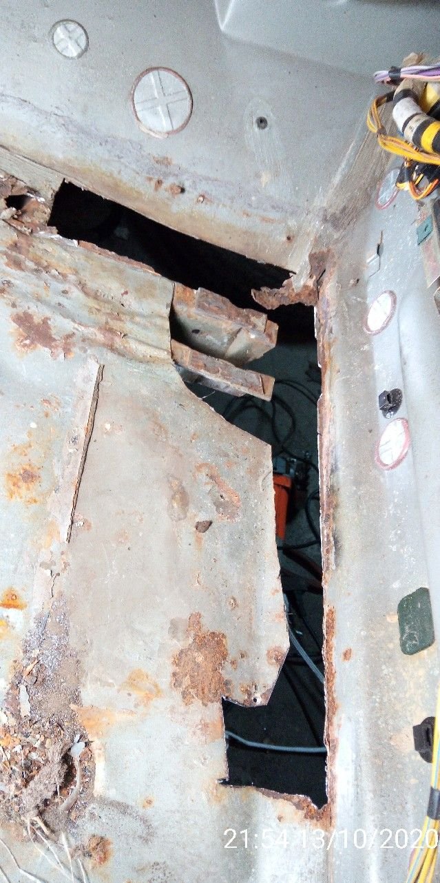

Default Still cutting rusty metal from passenger's front floor
Got all of the thin rusty metal cut out tonight in preparation for making and fitting patches tomorrow.
Think I got all bad stuff cut out
After I took this photo I cleaned up all of the edges where new metal will overlap and be welded.
