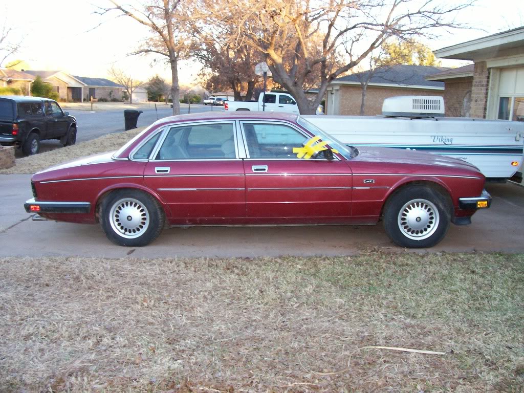

I have added a few photos of where I am starting. There are several rust spots, specifically around the windshield and roof that I will be addressing in the spring when I do the paint and body. A lot of the clear coat is peeling off as well. I hope to have this ready to paint by March - should have three vehicles ready to paint at that time! (The mirror that is taped on had been replaced - cows at my dad's farm have no respect for fine automobiles!)

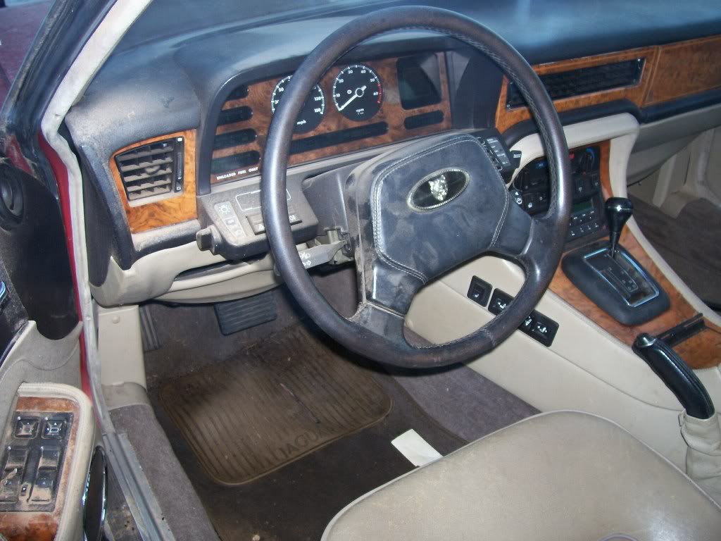

Interior will also need a significant amount of work, including wood trim, upholstery, carpet, and knee panel under dash. Got very dusty sitting in barn for couple of years. Will take some effort pulling panels, interior components and such to get dirt out. Don't want to just blow it around as It will get into the worst places!
