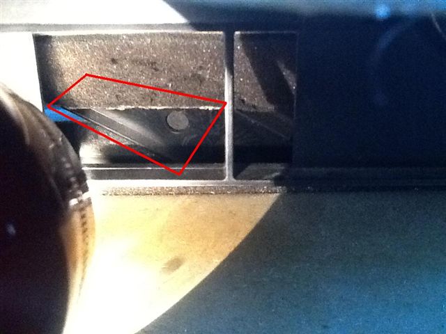

Thanks guys. Like anything this is a process. After taking the front vents out as well. I could see through the flaps and noticed that there is a plastic pc approx 30mm wide and not sure how long (150) that is loose and fallen, look like it my be a flap for the demist. Not sure how to get the top window vents or the top cover off.

I posted a while ago on getting the demister vents/flaps back in place by pulling them up with your fingers in the holes up at the windscreen and reinstalling the screws IF they are not damaged/broken.

I will try. Seems as though on my 1994 when I pull out the windshield vents there is another vent cover? Guess i'll see if I can get them out too.
Here is a photo of what I see looking in through the center vents

hi, i know this reply is very late as i have not visited this forum for a while, have you fixed the heating problem? i had a similar issue & completely removed the dash not to difficult to do & found the demister flap had come loose jamming the rotary flap at the top of the matrix.
