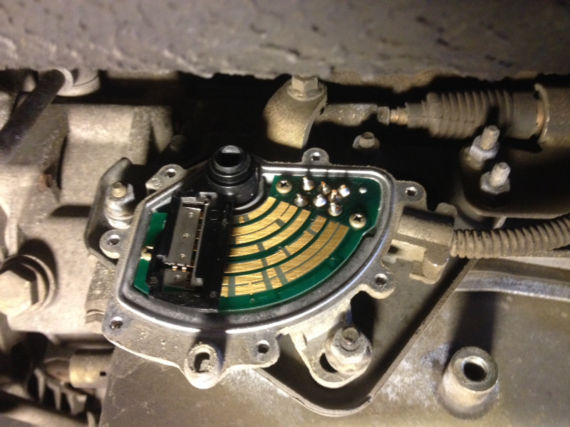

Got the car into position and set it up on jack stands . Took the cover off the switch and found ..... Wait for it....... Nothing. No appreciable wear. No dirt. I suspect a replacement used part would be worse than this. By the way, it's past 178000 miles. I will use eraser and 'electric cleaner anyway, but I promise I'll be as surprised as the reflowing of the fuse box in the other car if it works. I am leaning towards a worn starter causing excessive voltage drop on start up. But. We shall see.

I just reviewed Don's pics on the switch and he suggested this possibility:
The solder on the ends of the cable wires didn’t look too bad, but a cold solder joint isn’t always visible to the naked eye, so it’s a good idea to reflow the solder. First, clean the joints of all rosin and other contaminants with a small wire brush.
Reflow the solder and add more if necessary. Access is limited and the joints are close together, so take care to avoid bridging any joints, and follow up with a solder pick between joints to ensure that none have been bridged.
anyway, keep on keepin' on
Larry
I agree. It's very counterintuitive, but when you're looking for a problem you want to find one. In any case, I unhooked battery, flowed those joints, did the eraser thing, rinsed liberally with electric cleaner, checked progress - with switch cover off (Doh!) - of course failed. Reset battery again, reassembled switch and light is out..... Fingers crossed!
