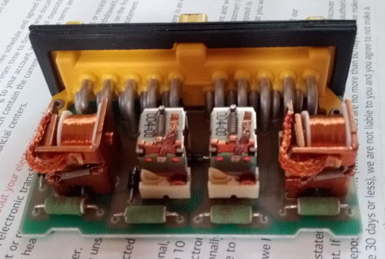

I am looking at the inside of one of my malfunctioning DBC10009 relays and I see four separate relays inside that control four separate electrical circuits.
Can anyone tell me which relay inside the case is for the running lights (front marker lamps and rear taillights) ?
They are labeled like this on the outside of the case:
1 Auxiliary Positive
2 Sidelight Positive
3 Auxiliary Sidelight
4 Cigar Lighter
but there is no way inside the case to identify which is which exactly.
Here is a photo showing the interior of the relay.

Old Aug 10, 2020 | 11:44 AM
Lawrence's Avatar
Posts: 2,729
Likes: 1,910
From: Victoria BC Canada
Just reflow them all
Larry

Last night I did finally try reflowing the solder points in a couple of the DBC10009 relays I have here that were exhibiting the symptoms. I was unsuccessful with the first relay but after doing about 40 - 50 percent of the points in the second relay I now have what I believe are reliably working taillights and front parking lights.
Larry
Steve,
Were you not able to access the other 60%-50% of the joints? As Larry said, it's a good idea to just re-flow and supplement all the joints you can access.
