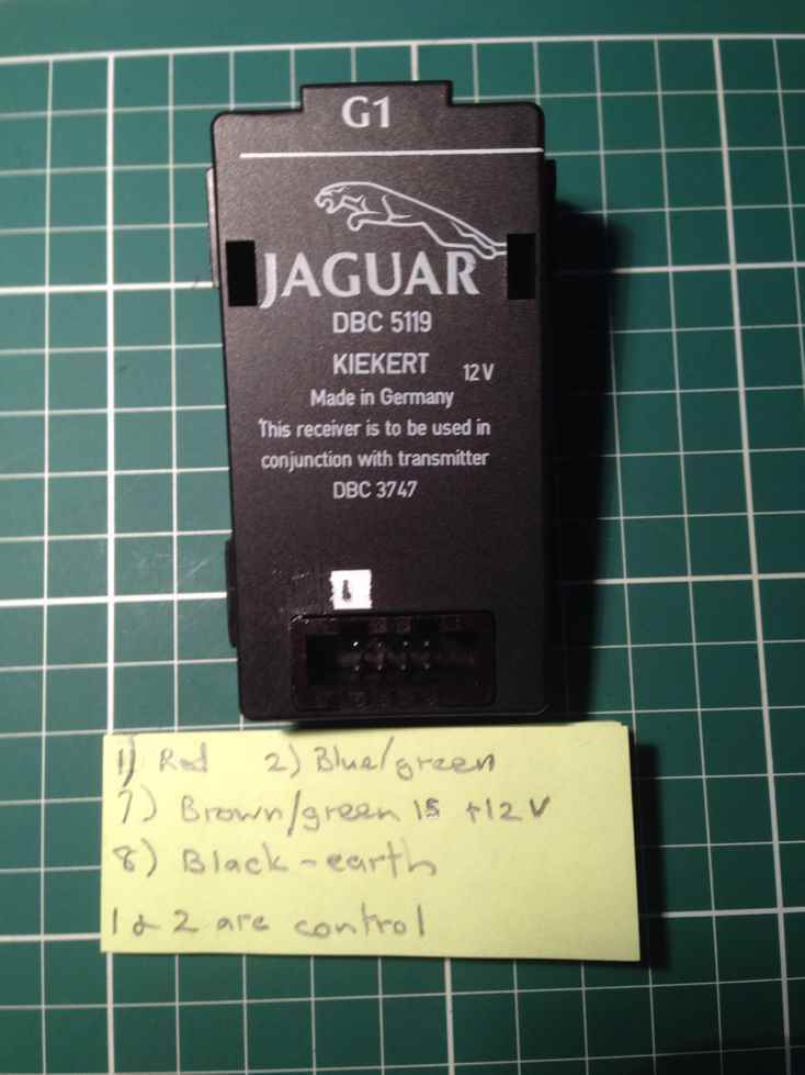

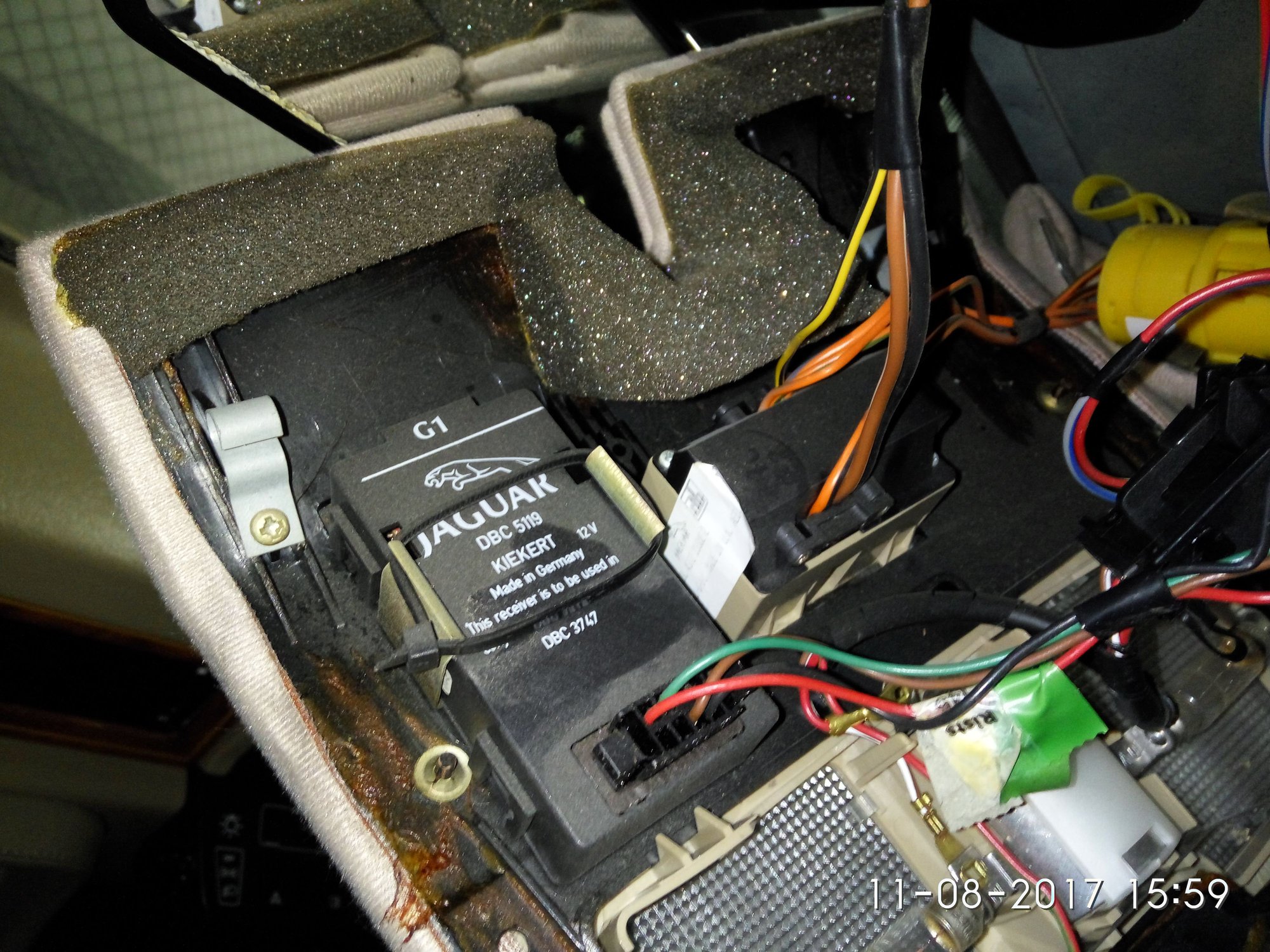

Helllo All, I am in search of wiring info on the Infra red remote receiver DBC5119 for keyless entry. My key fob IR remote has a dead chip in it , I cannot replicate the remote lock or unlock operation. I already have an excellent rolling code keyless entry replacement but I have not been able to determine what signals leave the DBC5119 IR remote receiver. See the picture attached. There are 4 wires leaving to the locking control. The black wire and the brown wire are battery power and the control wires green and red I believe are the lock and unlock signal. As my key FOB is dead I cannot test to see what the output signals are from the receiver when lock or unlock is initiated from the transmitter key fob. My assumption is it is a grounding pulse on either Green or Red wires to enable lock or unlock. Can anyone confirm this please.
Regards from Rod
IR remote receiver DBC5119 mounted in the above overhead interior lighting console
What are the signals output from the DBC5119 infrared receiver on pins 1 & 2 to the CCM and central locking ?
