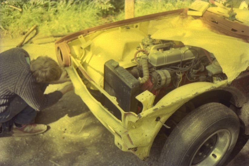

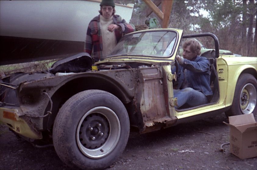

Ok Don, I found the old Triumph pics - first, my TR6, before and after.
arriving in the yard, sometime around 1983:
work in progress:

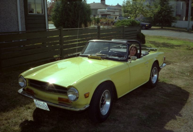

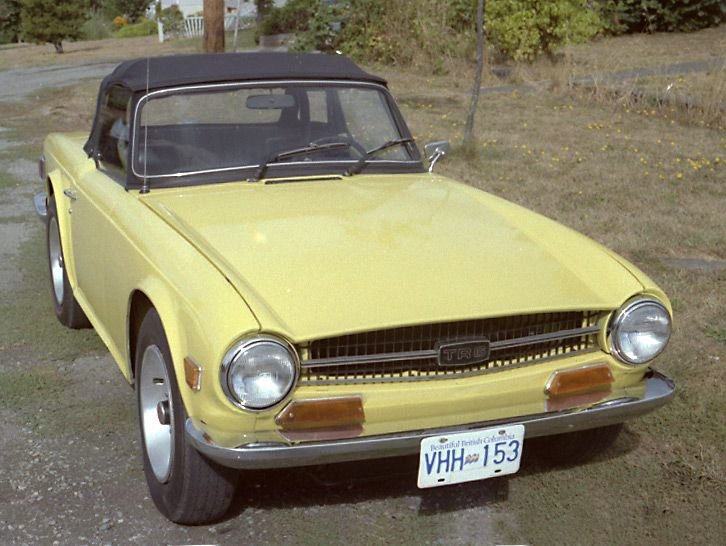

and all finished up!!:
Top down and the missus at the wheel

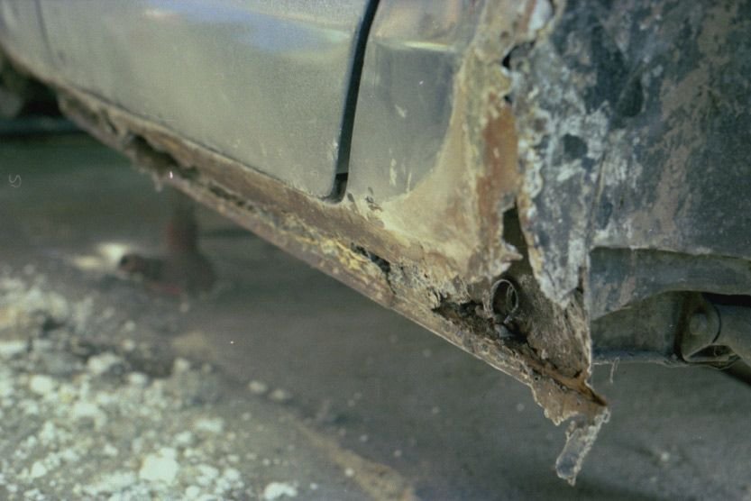

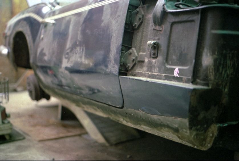

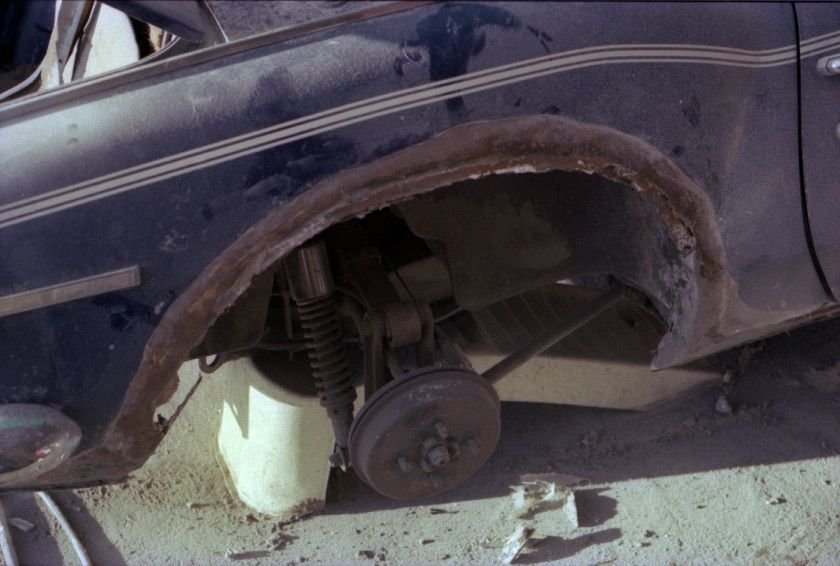

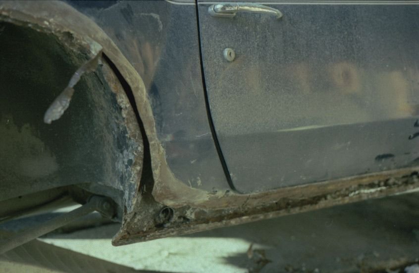

Unfortunately I only have pics of the repair on the Spit so you'll have to use your imagination as to where these shots "fit in" - anyway, here goes - started on a Monday and she was painted on the Thursday IIRC!!
State of rear wheel arch

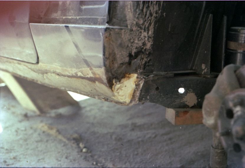

Sill front and end cap
rear wheel arch

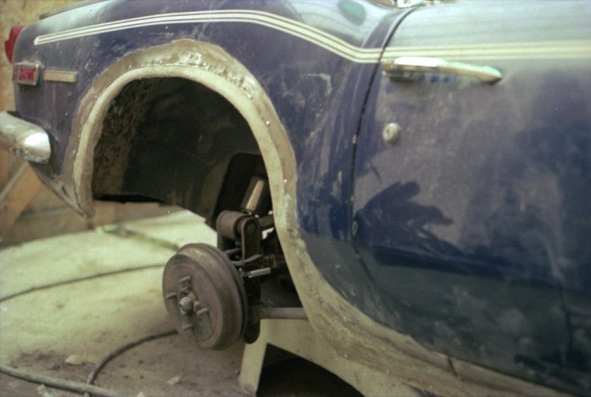

plaster fill
plaster of paris fill
Plaster knocked out, cutting away rusty bits
plaster knocked out, metal prepped and fibreglass cast section pop-riveted in
fibreglass section pop-riveted in, front

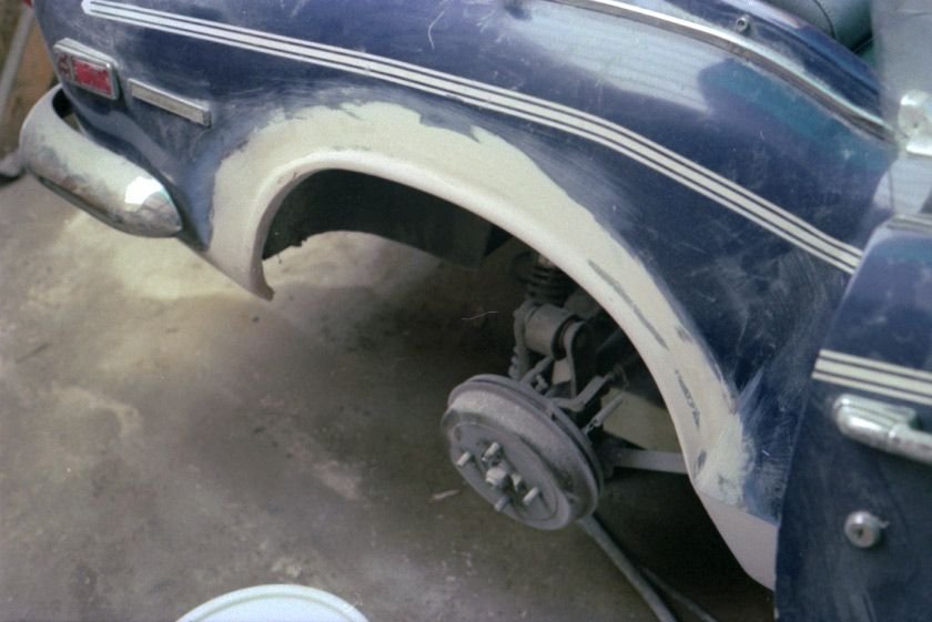

Smoothing out the repair
Ready for paint!
I thought I had a picture or two of the fibreglass layup, (which I did over the plaster) but couldn't find them - hopefully the pics show what went on!
Anyway, there you have it, wreck to presentable in 4 days!!
Surprisingly, once the section was riveted in, the repair was quite strong and afaik lasted the life of the car!

Terrific, Larry!
And I always wanted a TR6. Love those cars. My uncle had a TR250, which was the American version of the TR5, with IRS. A great car I should have bought from him before it got away.
