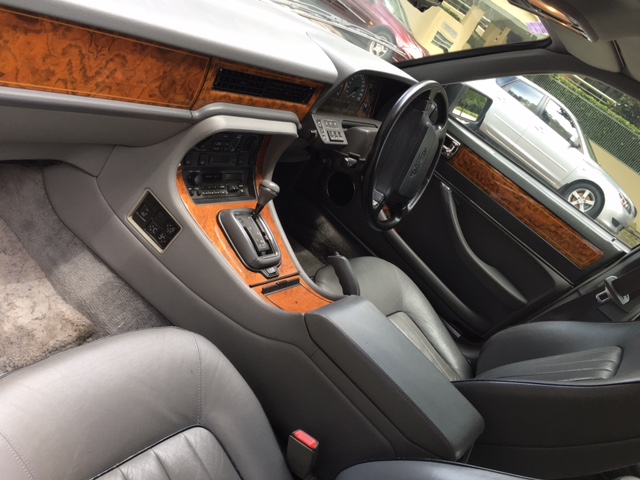

Ladies and gentlemen,
My name is Dave, in Sydney, Australia, and today I took ownership of a lovely 1994 Daimler Double Six. It's in pretty good nick, with only 92000 kms, but that's certainly not to say that there aren't some things that need attention. While my mechanic will set some things right, I expect I have some tinkering ahead of me. I don't expect to be driving it everyday, but 2-3 times a week will be enough to give my XJS a bit of a break.

Hi Dave,
That is a gorgeous car, with very low mileage (how do you say it in metric, "kilometerage?")!

Dave...
Your cars look incredible. I've always loved that color. Do you have any more pictures or a thread detailing your XJS?

Thanks Jeh. Neither is car show material, but both are pretty good daily drivers. I'll be putting the XJS on a more restrictive registration soon, as right now I'm only driving it about once a week.
In the meantime there's always some tinkering to do!
