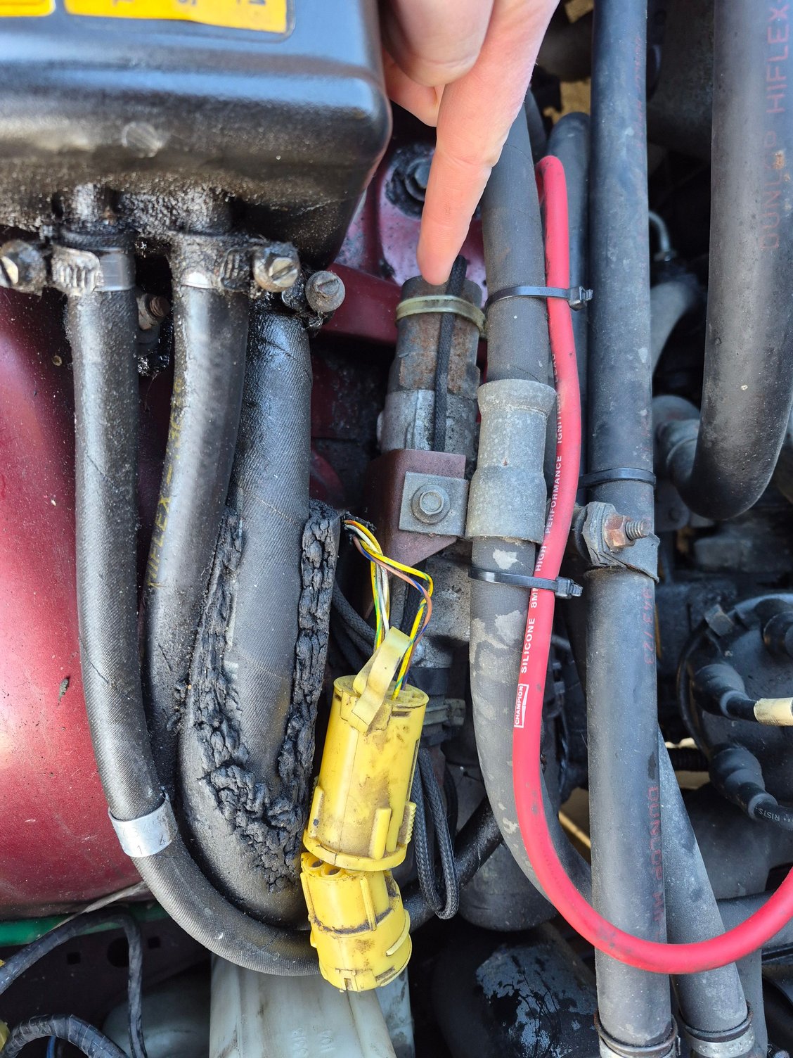

I’ve just purchased myself a 1990 Daimler XJ40 4.0 and it has some issues. This is my first time owning a classic Jag/Daimler so it is all new to me.
The first issue I noticed was the valve block was unplugged electrically, I plugged it back in and the unit immediately started to pump like a ticking clock, it did not sound right at all so I disconnected it again, there must be a reason the previous owner unplugged it. There was also some pipes in the vicinity that looked like they should of been connected to said unit but were not.
I think this unit controls the ABS and ride height? I also have a anti-lock light on my dashboard, could this be why? if it has been purposefully disconnected how has it been passing a MOT with the ABS warning light on the dashboard?
So I guess, what is wrong with it to make it pulsate? and how can I clear the anti-lock light off my dashboard?
Another light on my dashboard is the bulb out light, all my lights work, so how can this be removed also?
The car also has a lightning bolt amber light too, the VCM says FUSE 1. I’ve checked every fuse in the A pillars and centre console for continuity and all checked out. Puzzling.
Thanks,
Craig

Do a thorough walk around for lights. There are marker lights in the side/ ends of the bumpers that go unnoticed (just had one this week). Check all flashers with hazards on. As for valve block, do you mean the ABS unit? This has all the brake lines plumbed through it but the black reservoir bulb usually goes bad so that the abs system thinks theres a problem.

This thing.
This thing.

The picture I posted earlier must be the ride self levelling device, it must be disconnected as the MOT guy said the rear has standard coils etc so must of been converted?
