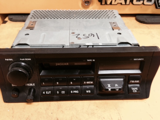

If your keypad isnt working and a battery reset doesnt fix, I would think the unit has failed. But if its already broken what do have to lose.I would take it apart and look for a loose cable, broken solder joints ect.
If It doesnt work after that i would think its time for a new/replacement unit. Personally I would go with an aftermarket unit. If you need a factory unit I have one I pulled from from 94 XJ6. It worked fine but I missed my AUX IN from my phone, so I changed it out.
If you are interested send me a PM and we can work something out.
Joe

Jeh's radio looks good PLUS it has the code ...sounds like a great offer!
