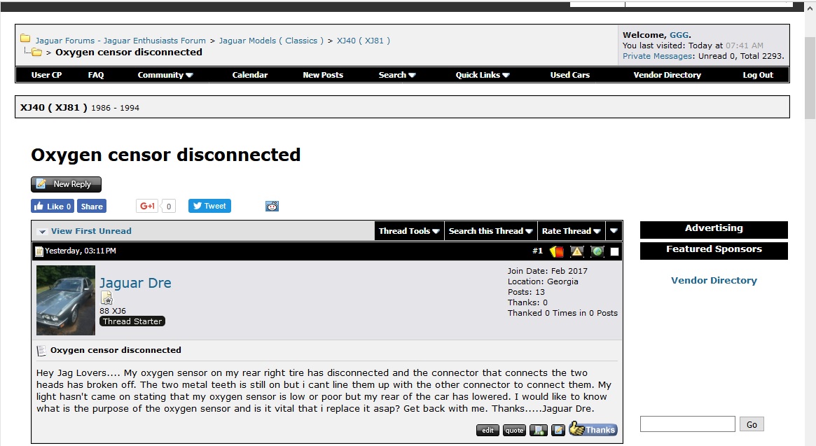

No need for CENSORSHIP in this thread.
Attachment 148207
Thanks, Graham.
Since we're confident the OP's issue is not with the oxygen sensor, I was going to wait to re-title the thread until he provided additional information based on the input we've provided thus far.
Cheers,
Don
