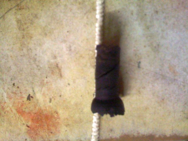

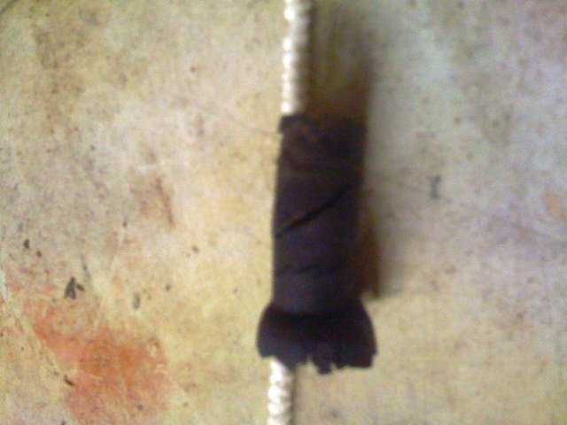

This little rubber hose is a connector is attached to the purge valve. Problem is, is that it is one of a kind, larger on one end and smaller on the other, I don't think it even has a name. Anyone know the name and where I can get it? Second part is, was this purge valve on cars 89-94?

Here's a breakdown on that system. It looks like you need #7 ... "reducing hose".
At least that will give you a description and part number to work with.

Looks like you will have to order from Jaguar. Good news is they are not expensive, less than $5. Part number is EBC10152
