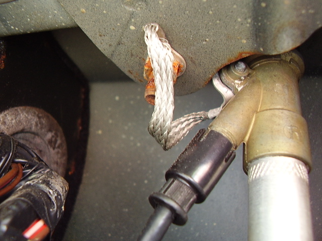

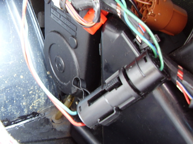

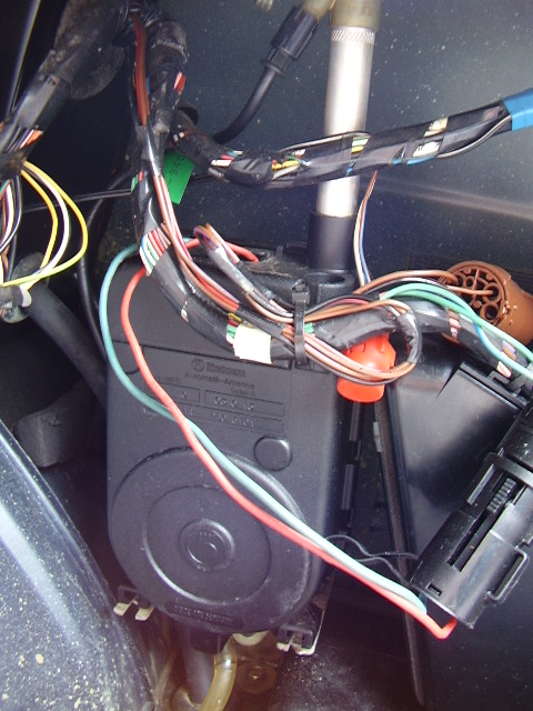

these photos may help you, but bare in mind my car is a 1990 and MAY be different, but i strongly doubt it. if i`m correct, the aeriel changed on the later cars, perhaps 1993/4, but i`ll stand corrected.
wires off the aeriel to plug are GREEN and RED. one does `up`, the other `down`, but i cant remember which way round.
off the loom to plug, are GREEN/RED and GREEN/BLUE.
the earth is from the aeriel `stem` just under the wing/fender and bolts to the body. glad i took the photo for you now, as mine has rust on, which i can now sort before it gets bad!
