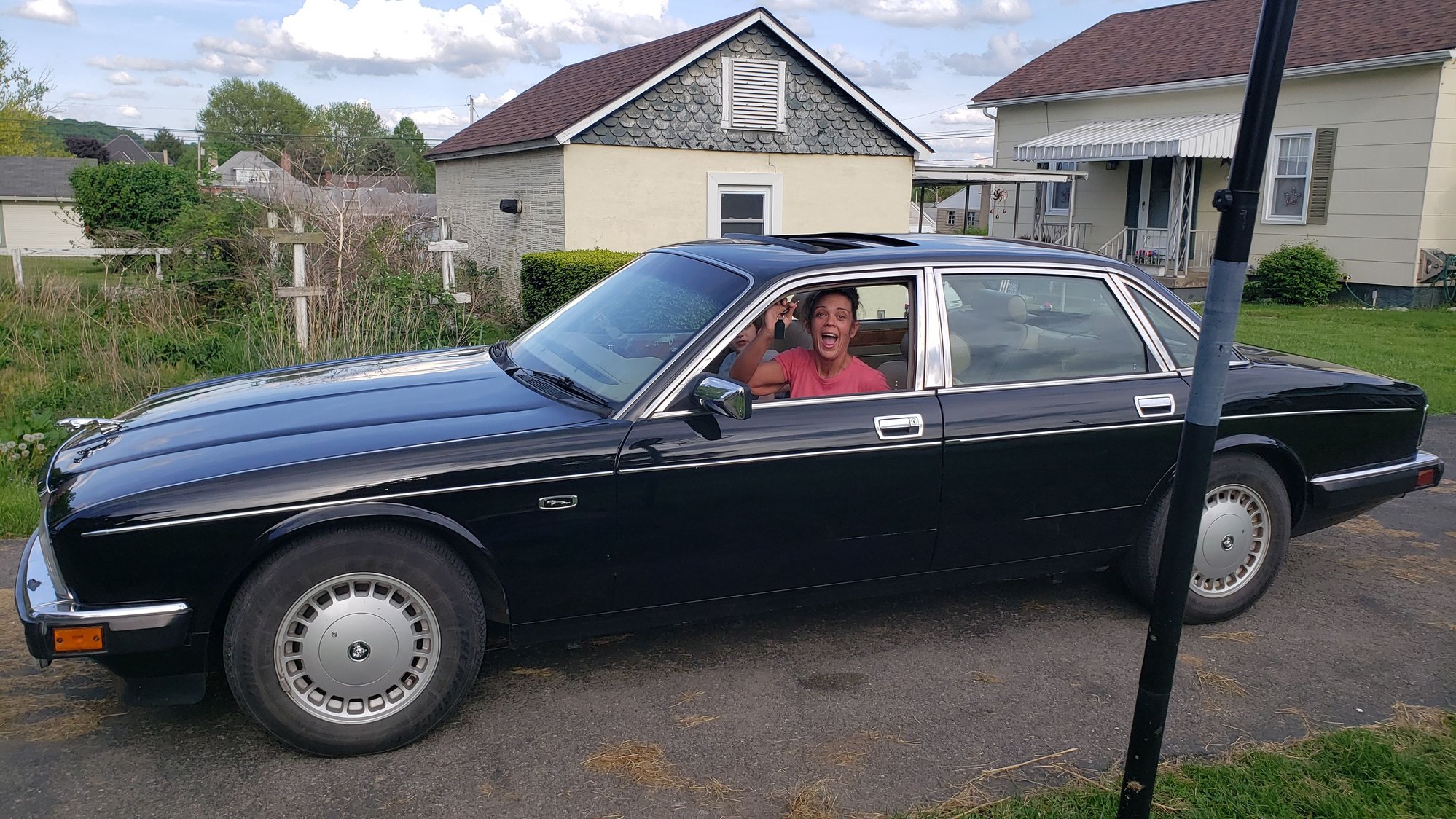

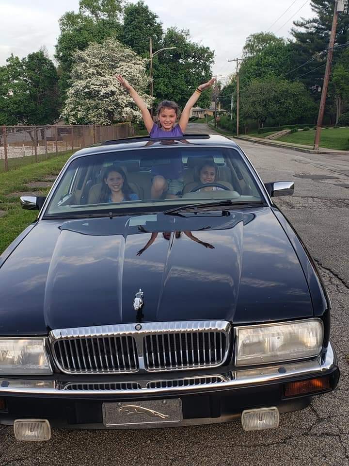

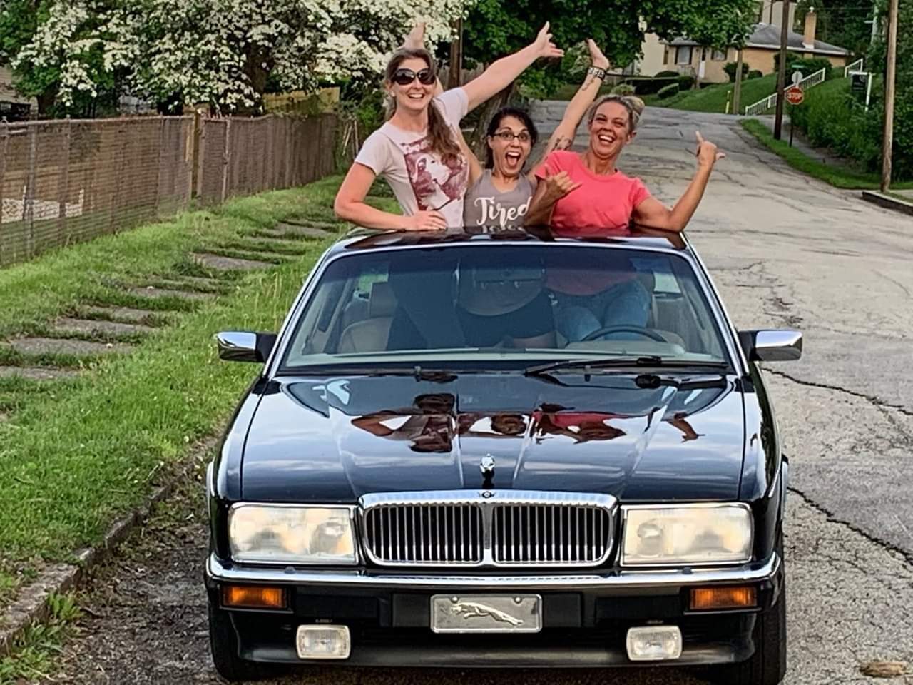

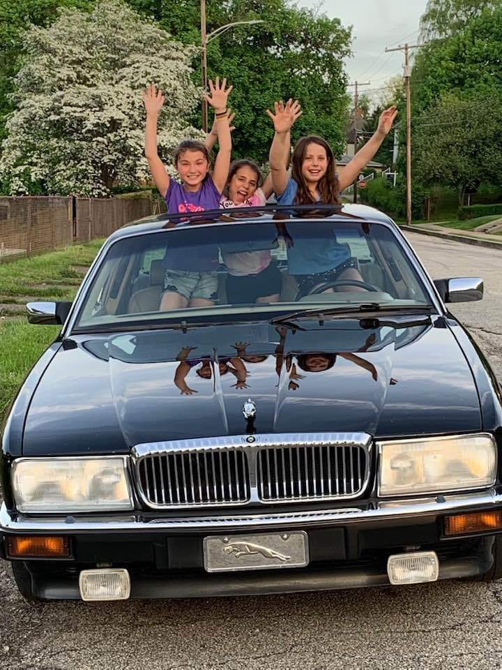

Thank you for the advice and information, I figured out that was the problem earlier today as I was overloading the head unit and am currently looking for an amp. I had the code for the factory stereo however it would not even give me the option to enter it and it felt as if the radio selection buttons didnt depress properly. I didnt want to take a chance with it and I would prefer since this is going to be here Sunday driver that bluetooth was in the car which is why I wanted to go aftermarket. Here are the few pictures as I am at work right now

That's a great-looking XJ40 and some very pretty and happy ladies!
Thanks for sharing!

That's a really great-looking XJ40 and a very pretty driver!
The friends and kids seem very happy too, which is an entirely appropriate response to a Jaguar!
