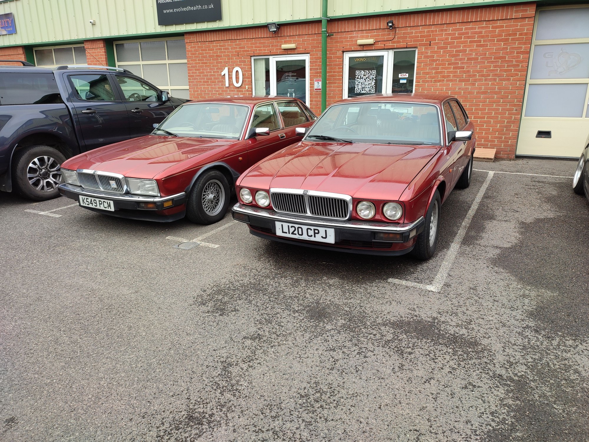

I have one early xj40 and one later one. The later one has the cast rear arms, and due to plans I have for the cars my intention is to swap the rear suspension arms from the later car onto the earlier one.
Other than the shock and spring assembly being different, is there anything else that I would need to take from the later car to make it fit? IE are the hubs, cv axles, mounting points, bolt diameters etc all the same between the two?
Many thanks
