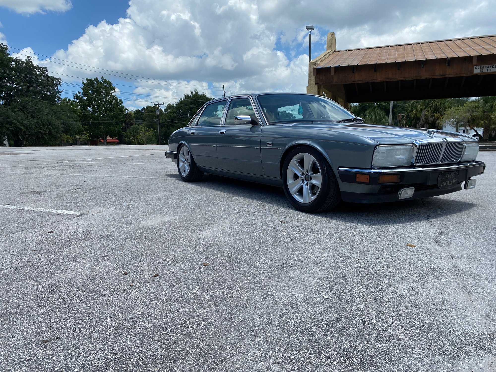

1991 XJ40 Sovereign
so I’ve had this sound coming from the rear passenger wheel since I’ve bought the car and it’s killing me when I ride with the windows down as the noise reflects off passing cars and even the curbs on the road or driving past a fence.
It is a constant squeak/grinding that is in rhythm with the wheel itself. The noise goes away when I press the brake pedal. I’ve greased the brakes, cleaned the rotors and even the brake caliper. I even changed the pads although the ones on it were brand new. The first time I greased the brakes the noise went away for less than a quarter mile then came right back, i greased everything again and the noise remains.
my thoughts are: wheel bearing, wheel
hub, caliper?
any help is appreciated 😁
